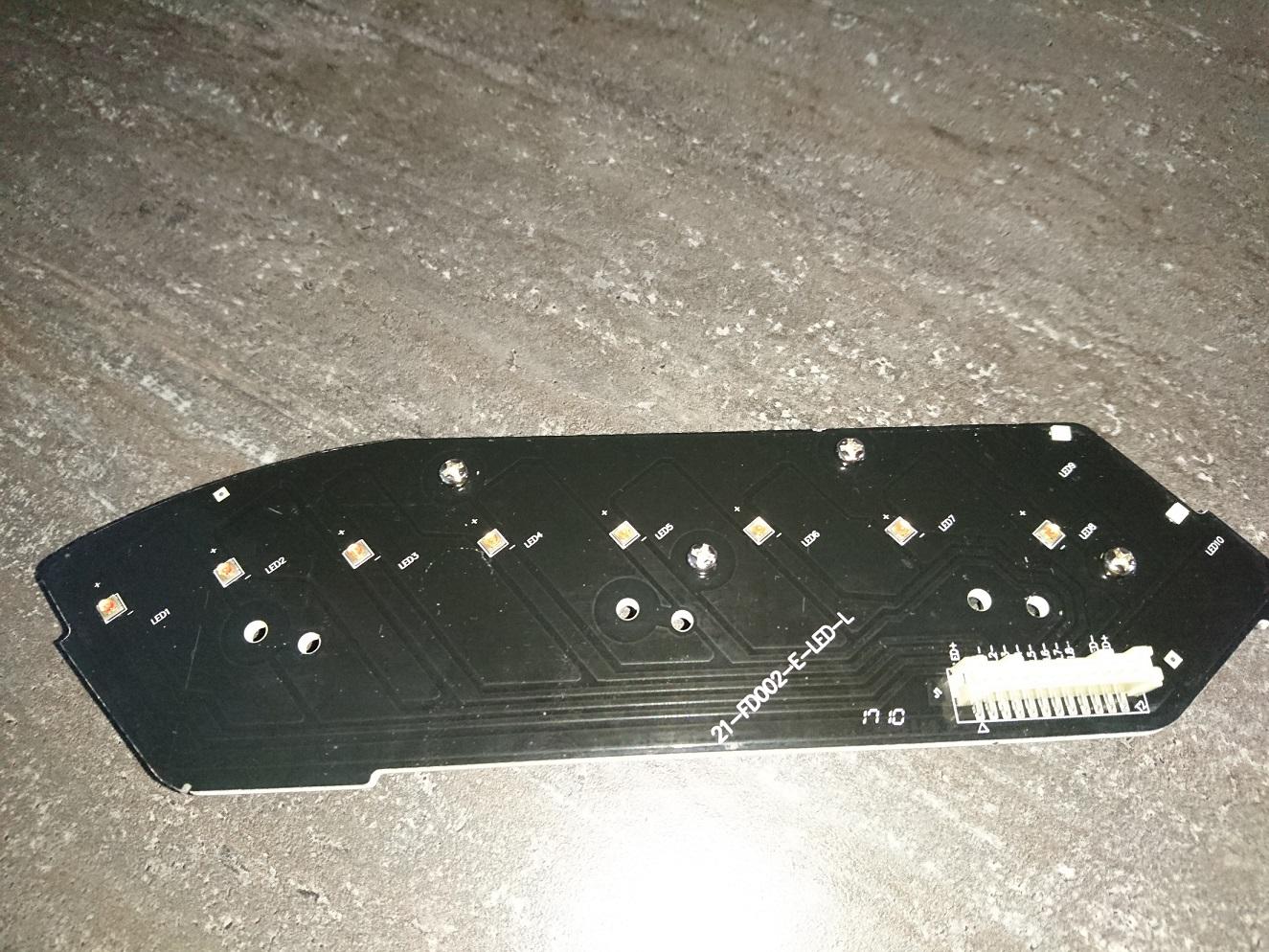

It's not a LED strip, I used single LED chips (9 per light) :thumbsup:

You have not enough space to put a LED strip, also you'll not have a good light output because of the reflector inside.
That's the LED board inside (8 amber chips for turn + 2 white for parking light):

That's not my work, it's the OEM board. On top of that, I added 9 white LED chips (next to the amber ones) to have the DRL feature :thumbsup:

You need : 18 chips, 2 power converter (DC12v to DC3.3v), 2 switchback modules and also pay for RnD :D :headbonk:
