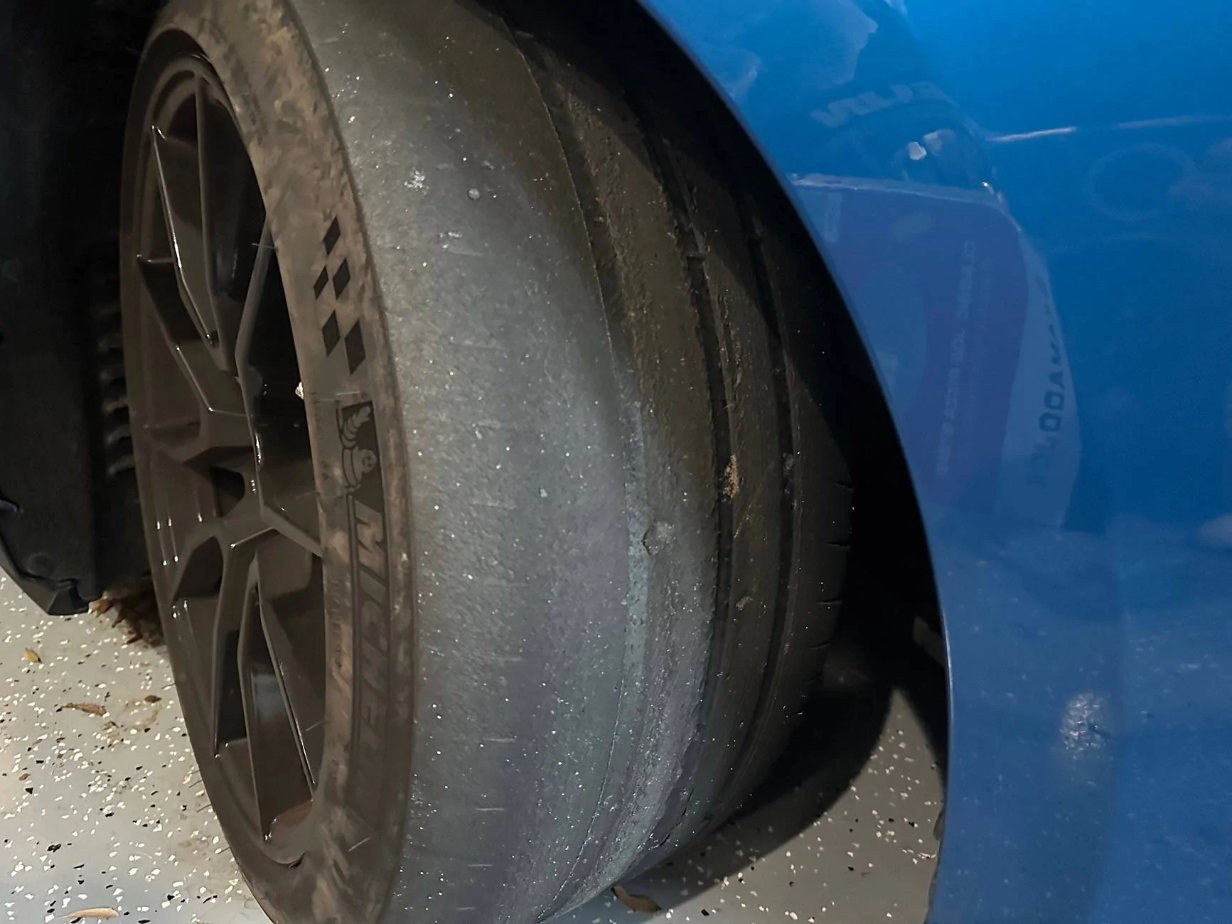

I did a track day yesterday and my Cup 2 fronts look like they might be done. This is my first time using Cup 2s on a track. Do these need to be replaced or can I use them for another track day?
One thing is clear - the tires wore so badly on the outside of the fronts that I think I need some more negative camber before the next track day.

A few laps left in those.

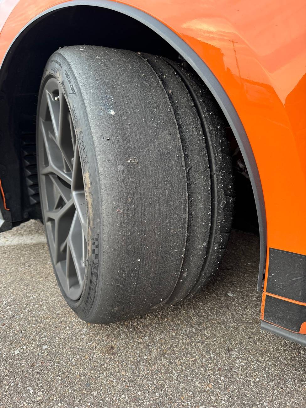

Looks identical to mine after1000 street miles and then 2 track days

OP still has some sipes on the shoulder !

Sooooo....mine are good to go for another track day?
That outer shallow groove is only 3/32" deep when new, and yours is still showing.
The photo in @Davesvt2000 's post shows that the groove is gone and he still has track time left.
I've seen guys retire their Cup 2s once the outer shoulder shows cords, and that is my plan too.
