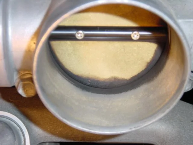

My oil catch can gets most, the intake barely has a film at 15,000 miles.
