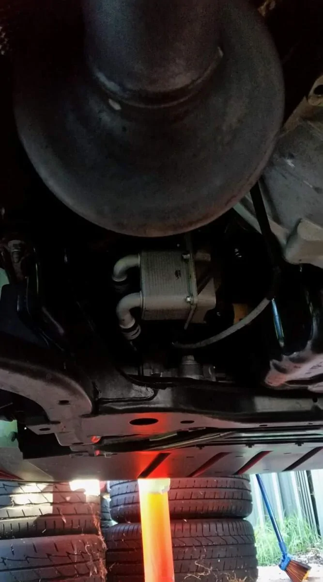

You're right, the RHD oil cooler is in a different spot.
It's a water to oil cooler.
This picture is taken with my car up on jack stands, I'm under the left hand seat, camera facing forwards.
The cat is the big round thing.
The oil cooler is the little square box in the centre of the picture. It looks horribly useless at cooling anything, and super fragile to boot.
