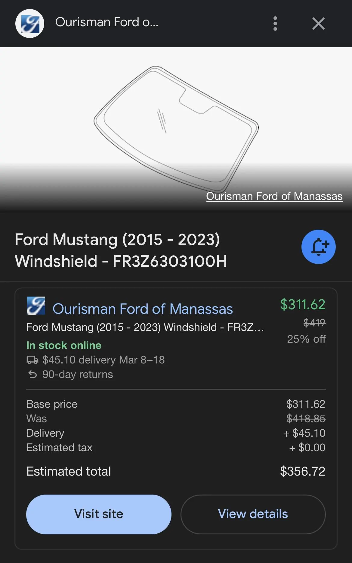

I believe this is it

Many thanks. I have
seen both FR3Z-6303100-H and FR3Z-6303100-C.
I don’t know which is right for a GT 50 PP Convertible?

Actually the difference between those two is not the body style, but rather with rain sensor or without rain sensor.
FR3Z-6303100-C is replaced with FR3Z-6303100-J and it is for vehicles WITH rain sensor.
FR3Z-6303100-H is for WITHOUT rain sensor.
