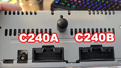

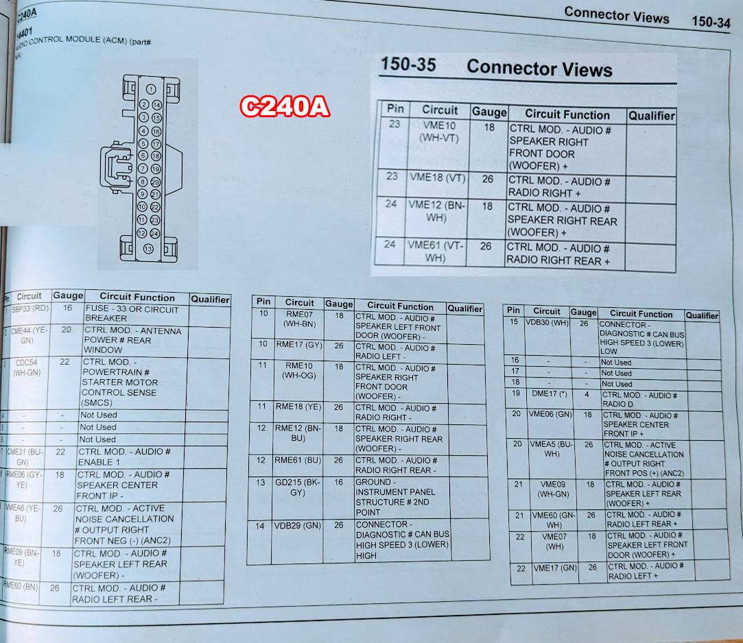

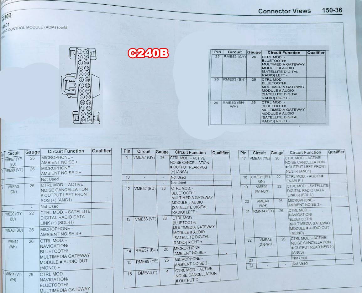

I assume then this is what I use to power the Amps on RCA via the Speaker pins
I need to make sense of the OEM Ford Factory wire diagram book I have. I assume then only the 9 and 12 use the Audio Digital signal processor which is above the amp too.
I assume the pins out are the same for all ACMs
I took pics out of the book and photoshopped them to make it portable on my phone.
Trying to figure out the pins needed for RCA and what went to AMPS and what went to Speakers.
