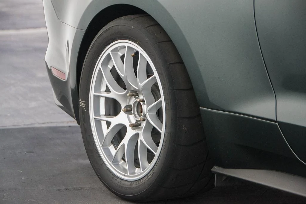

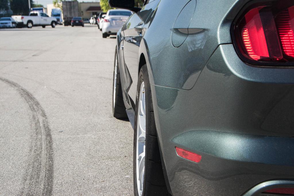

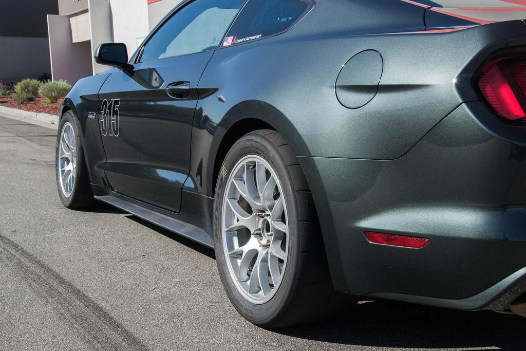

Here is an 18x10" ET43 with a 305/35-18 NT01 mounted. No spacers in the rear were needed for inner clearance. Obviously the height of yours rears will be quite a bit taller, however this should clarify inner and outer clearances.
This S550 track car was running them on all four corners, so the fronts definitely needed spacers to clear the struts. Once we came out with our 11" wheels, he switched to those for much better sidewall support.
- Ryan
