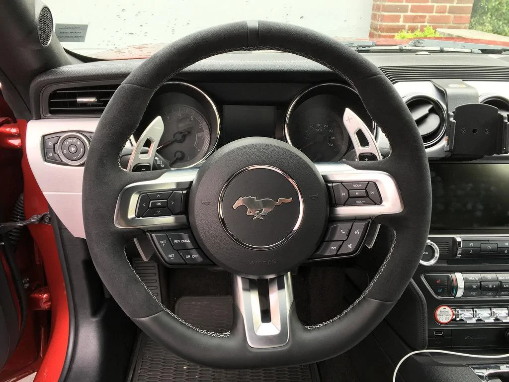

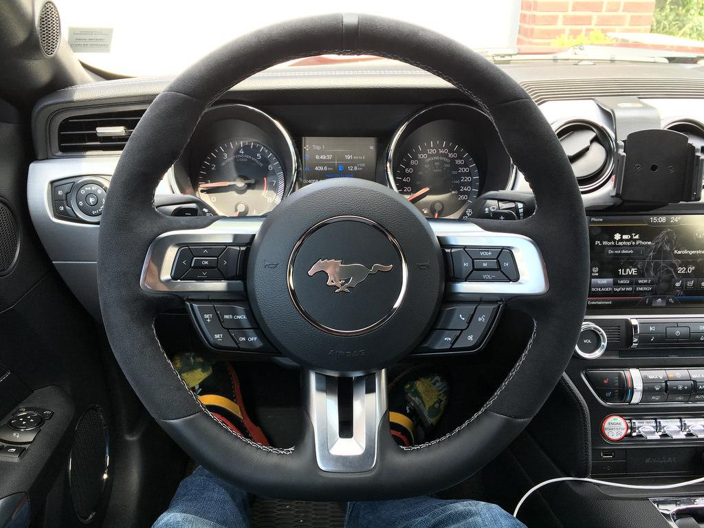

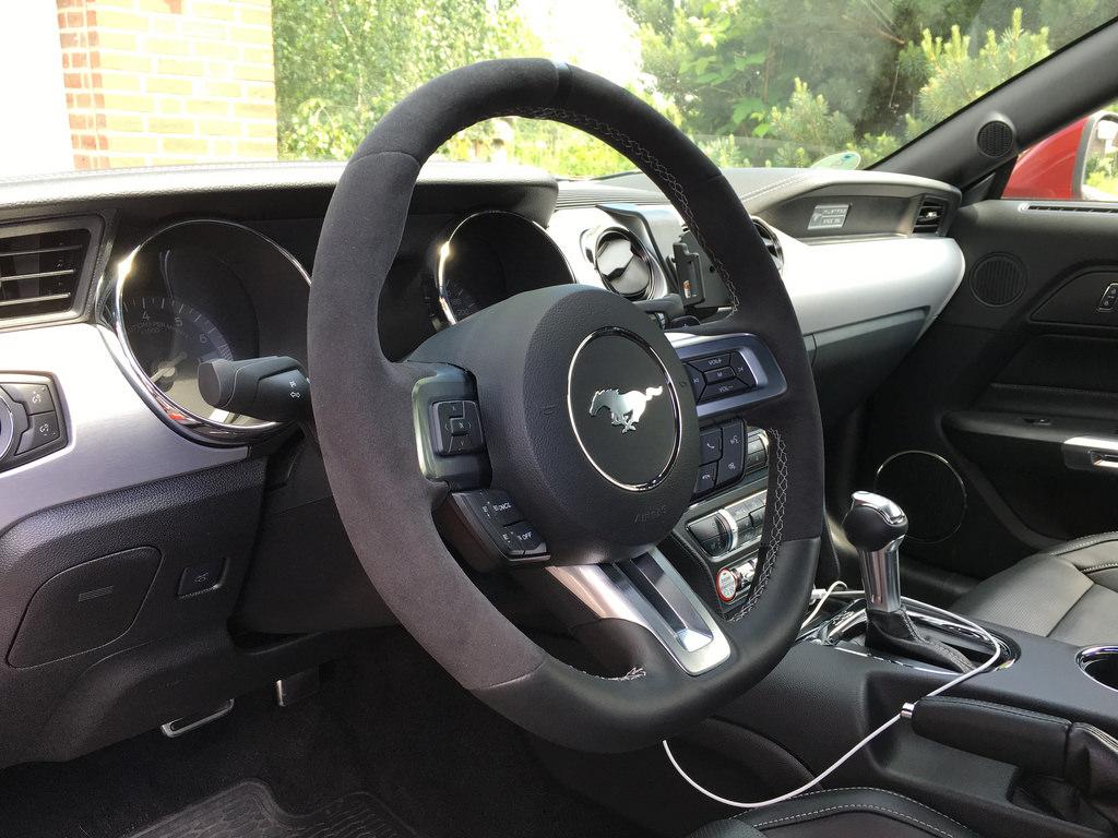

New GT350 Steering Wheel fitted. Easier than I thought and feels soooo good while driving.
For those who wants to know, the GT350 wheel is somewhat thicker from 9 and 3 below. Above feels and looks exactly the same.

Managed to get the paddle extenders off using wife's hair dryer. Then 40 min later I had the new wheel fitted. Paddle extenders now also fitted again and a pic will come.
Must say, the GT350 wheels truly feels great while driving. Grip is sooo much better than the standard leather wheel.

Well, in my case it was a little bit more work thanks to the extenders and auto but once doing its actually really simple! Took only 45 mins doing it slowly!
First and foremost, remove negative lead on battery! This also resets your adaptive auto and various sound settings, switches off your air cond etc. Need the 10mm socket for that.
1. Remove extenders, using wifes hair dryer to loosen glue of double sided tape.
2. Use a round long tool that fits in the holes behind steering wheel. Need a 24mm socket for this.
3. Pushing the pins releases the airbag. Disconnect air bag.
4. Unscrew big bolt for steering wheel and off it comes.
5. On an auto, one needs to move over the back of sthe standard wheel as this contain the harness for the paddles. Otherwise not as GT350 wheel comes with harness for manual as standard.
6. Move the bezels over and your done.
Remount wheel paying attention to the dit on steering column bolt and the arrow on wheel being straight.
7. Remount the airbag. Connect negaitive lead on battery.
Done!
Go for a drive and enjoy the better grip and higher quality grup that the cheap leather on standard wheel.
It may be necessary to do a wheel alignment afterwards as it may not have been perfect from the factory. Like in my case....only takes an hour and in my case was not easy to find a place thanks to the 20" wheels, but local Dealer can do it (same as where i took delivery from).
Oh, btw, there is an excellent video on here.....that helped a lot!!!!
