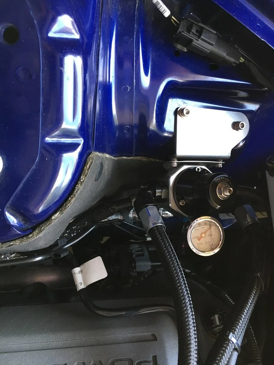

I was looking for a return style fuel kit for my Vortech to run E85. I saw a picture / post from another m6g member with hard lines who pointed me to CJ Motorsports. They offer a Whipple specific kit and now offer a Vortech / Paxton specific kit that is simply awesome!!! I didn't want a gaggle of fuel line and wire with a go-figure-it-out design. The CJ Motorsports kit is OEM quality and engineering:
(1) Reuses factory hard line for return
(2) OEM quality hard line for feed
(3) Plug-n-play wiring (no "controller")
(4) 2nd pump on a hobs switch for boost activation (inefficient to run two or three pumps full time)
(5) Proper pass-through design. The feed line goes to a y-block which feeds both rails in parallel and then both rails connect to the regulator. The budget kits deadhead to the regulator and then feed one rail with a cross-over to the second rail (poor design).
(6) OEM quality brackets and hardware (no DIY bending or hammering or fastening)
