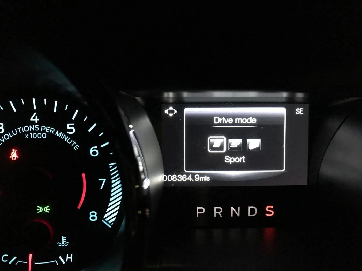

So last night I get in the car and drive off and find it's revving higher than normal.
Thinking it must be in Sport+ mode, I switch driving modes and find that the normal driving mode has gone, and all I'm left with is Sport, Sport+ and Race.
Anyone else seen this??

It's because your gearbox is in S, put it in D and Normal will reappear.

Same answer, gearbox in S gets rid of incompatible modes, mine's exactly the same.

Automatic gear box is in sport, not 'd'. When it's in 'D' wet/snow and 'Normal' will appear.
Or so my brief test of an auto in the 'states lead me to believe.
Change the stick back to 'D' and tell us if it's still happening matey :)

Exactomondo, as previously said!!!
