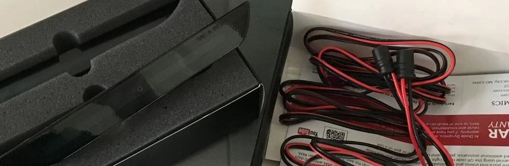

Thanks NicoMCH for sharing, do you have a better picture of the cables and can you share the installation guide ?
Thanks :cheers:
Here you go:
So the violet parts go into the 2 T-Taps that you have to put on the cable from the licence plate's light. The 2 black ones go to the side markers. The cable is a standard audio speaker cable on which they added the 2 ends, seems well build.
In the installation guide they make it sound pretty easy to unclip one of the licence plate light housings. Has someone tried that before? I kinda do not see how we can do that easily.

Mmmm.. looking at those instructions, something doesn't match with DD statement in reply to YLA G on 23\03\2016:
Thank you for following up on the EU harness. This harness is going to be completely plug and play! One end will connect into the taillight socket and the other will plug into the side maker. We wanted to make it a very straight forward installation for our customers.
Don't seems to me neither "completely plug'n'play", nor "connecting into the taillight socket". Instead, we have to install a quick connect harness that make a small cut on licence plate light wires.
Now I understand why that they save 10 bucks on harness!! It's only the connector on side markers, a piece of speaker wires and the quick connect harness (price 1 buck for A TON).
I'm a bit disappointed. I waited for the EU version just for the additional plug'n'play connector.

I can agree, it's not a plug & play solution...
But with that, you can connect the wires everywhere you want (licence plate or tail light).
I wrote DD an email as well to know how they get the light housing from the licence plate unclipped. They say "unclip" the light housing, so it should be easy :headbonk: or maybe Nick can give indications here :clap2::
Right, but it's a solution I can found myself - as you did when installing yours. Plug'n'play harness for taillight connector would be a very clean method.
When they refund us 10$ I would prefer if they said "guys we thought to give you plug'n'play solution but we can't find the connectors so we give you quick splice connectors and refund 10 dollars".
More, they refund us that money without explanation.. if no one asking here on the forum.

Mine arrived today. A bit disappointed that it's not plug and play. I'm never overly keen on the taps. The paper instructions are not great, but I'm assuming there's a video somewhere showing how to remove the plate bulb holders. Removal isn't obvious and they look really easy to damage. Got some 3M cable ties to stick onto the inside of the bumper so the wires don't flap around. Will connect up when it finally stops raining!
