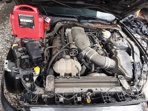

Post a pic of the blower. If it’s a gen3 or 4 it’s probably a lost cause. If, by chance, it’s a gen5 then you’ll be much better off.

Here is the only pic I have at the moment of when it came in and they took a picture of the underhood. I'm going to try to take a better picture of it on the pallet here in a bit when I get a chance and try to get some info off of it.

That’s a gen3/4 supercharger, most likely a 3. Very little of that system will cross over to your 2019, unfortunately. You’d be better off selling it and getting a proper kit.

If it was a gen5 it would swap over no issue, that one you have though will not clear the di on gen3
