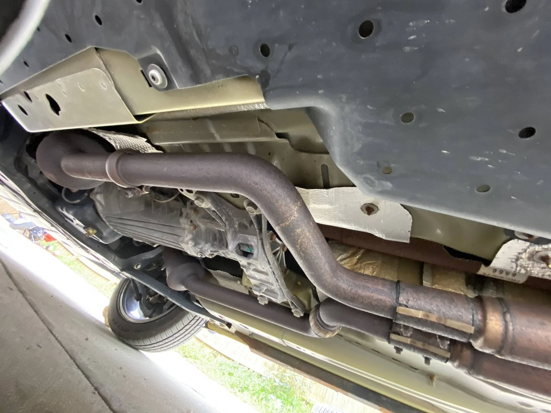

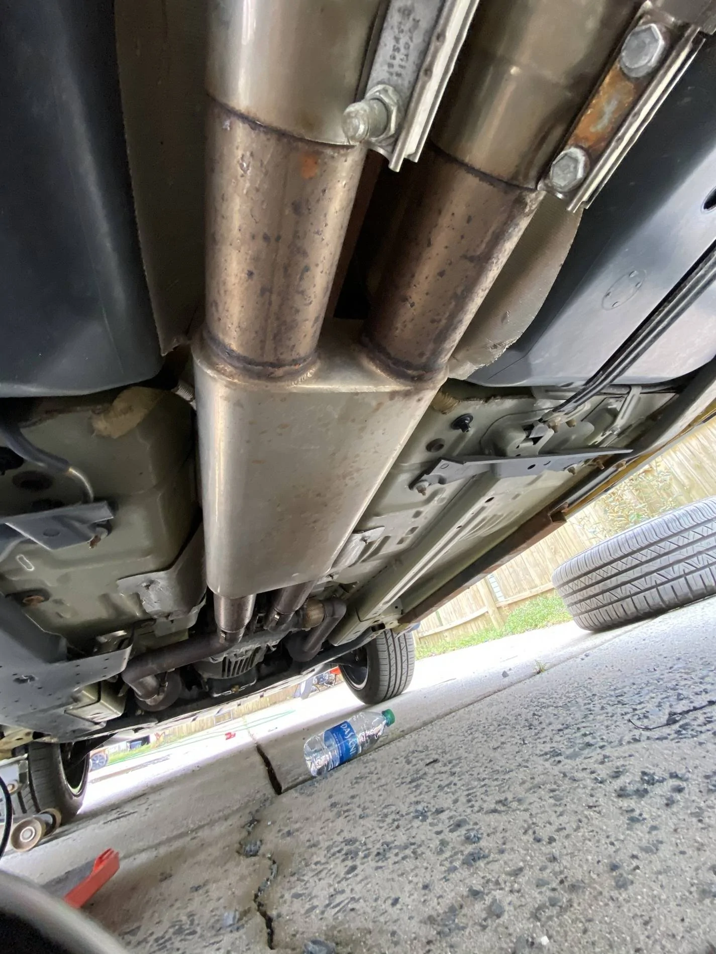

Hello all,
I bought a preowned 16 GT convertible that came with an exhaust preinstalled. I’d like to put some headers on it but I don’t know what exhaust was installed nor what is compatible. I was hoping somebody could identify the exhaust and offer some headers that would fit. It looks like it has J pipes and is 3” if that helps at all.
Thanks!

It looks like a solo Mach XV catback. It’s using the factory resonator clamps and location so any headers that say they connect to the factory catback will work. You may want to go with one that connects to 3 inch catbacks since yours is and eliminate the reducer at the front of your catback. You can’t go wrong with ARH, Kooks, Corsa, Stainless Works to name a few but they’re pricey. On the lower priced end there’s Texas Speed, Stainless Power, or 2M fabrications.

That’s definitely the exhaust! 3” all the way back is the goal. My old eco had a reducer between the dp and cat back. I couldn’t believe the difference after I eliminated the reducer. Thank for the help!
