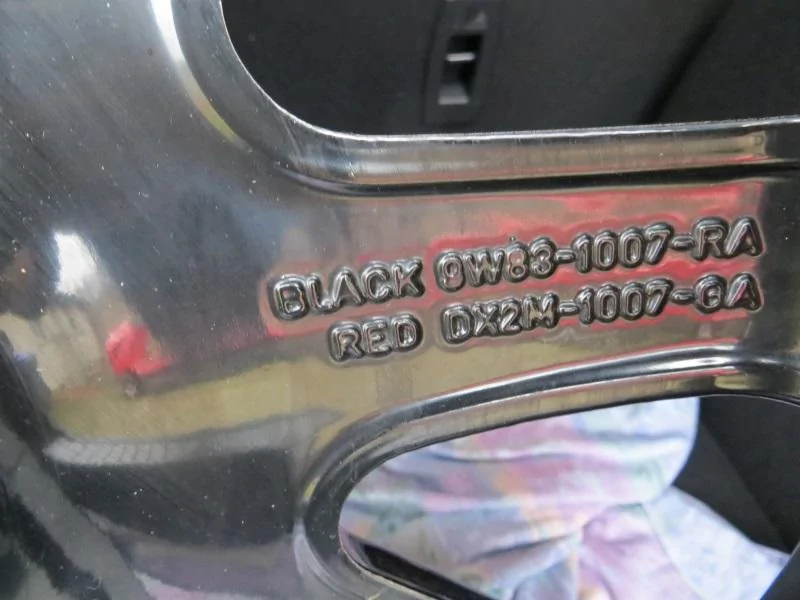

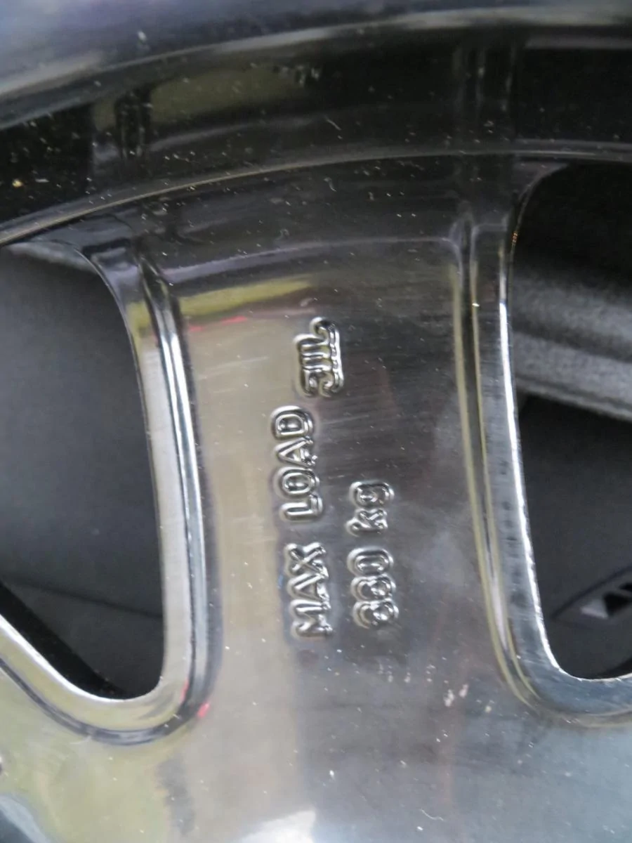

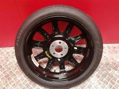

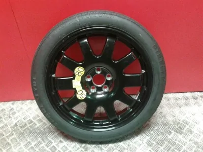

First of all, get yourself a 19 inch x 4J space saver wheel for a Jaguar XFR.
Available in black or red it seems.

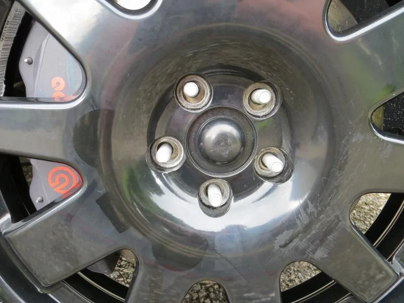

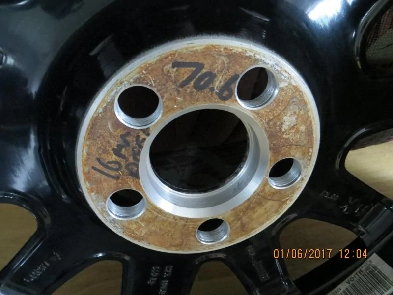

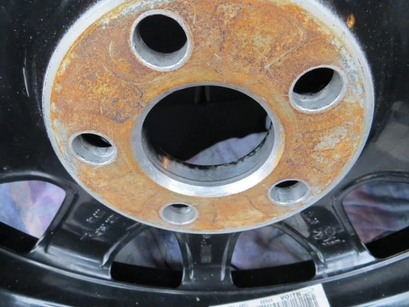

Machine the centre bore to 70.6mm diam. x 16mm deep. This clears the hub spigots front and rear. I didn't machine all the way through as it looked like it might get a bit thin at the top of the stud pockets. A bit of judicious filing of the stud holes might provide clearance for the studs, I opened the holes out to 7/8" (22mm). This allows a little wiggle room and makes sure the wheel locates on the bore and not the studs.
Before:
After:

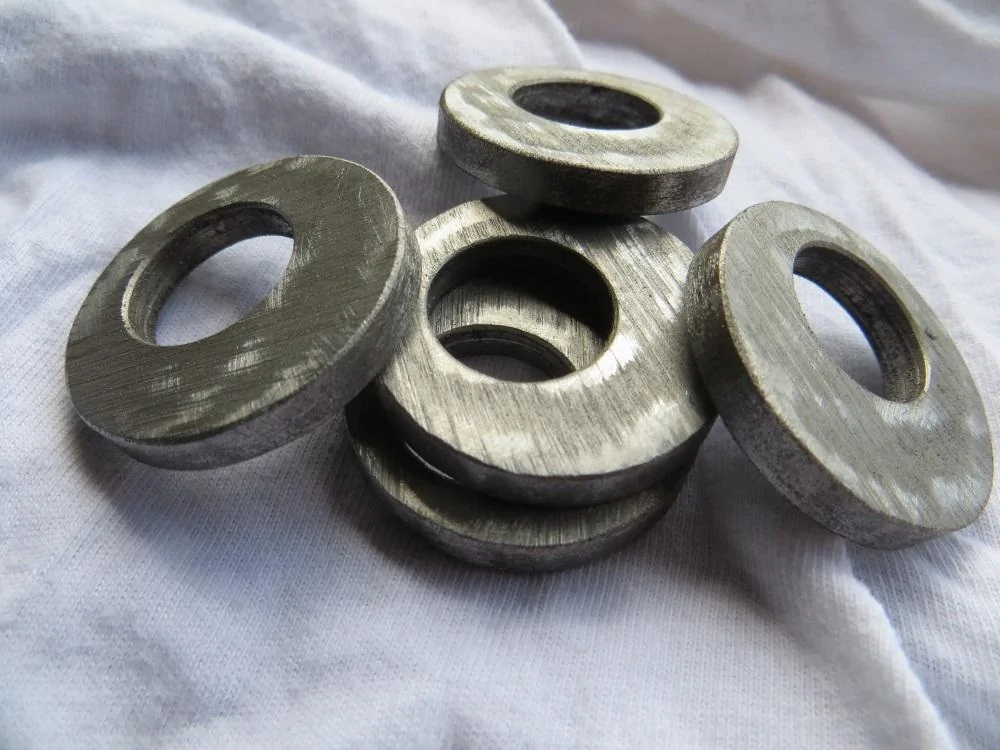

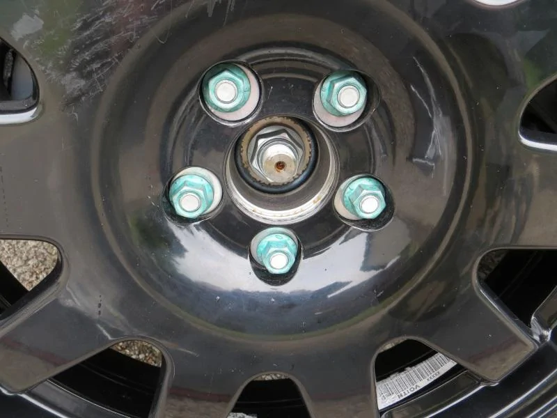

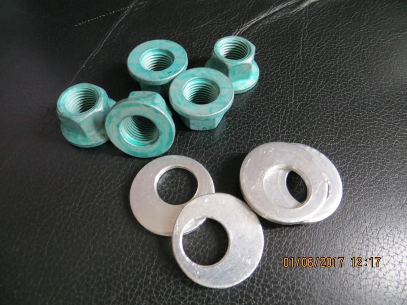

Next you need to acquire a set of wheel nuts from a Mercedes Sprinter (Febi Bilstein 22474). Then make some offset washers 32mm OD with a 16mm hole offset 3mm from centre. I used 3mm thick ally to start with. Too soft.
Ally washers replaced with mild steel washers 5mm thick.

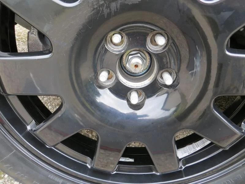

Fitted to rear:

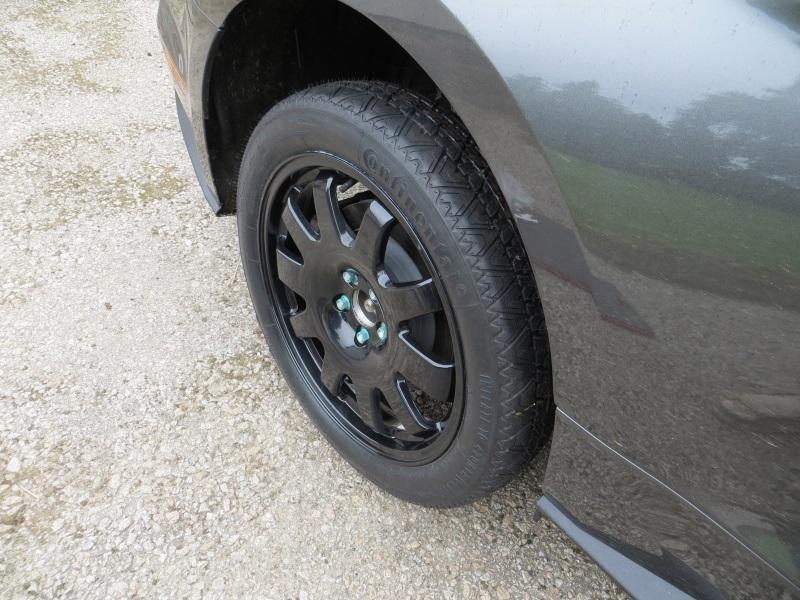

Fitted to front:

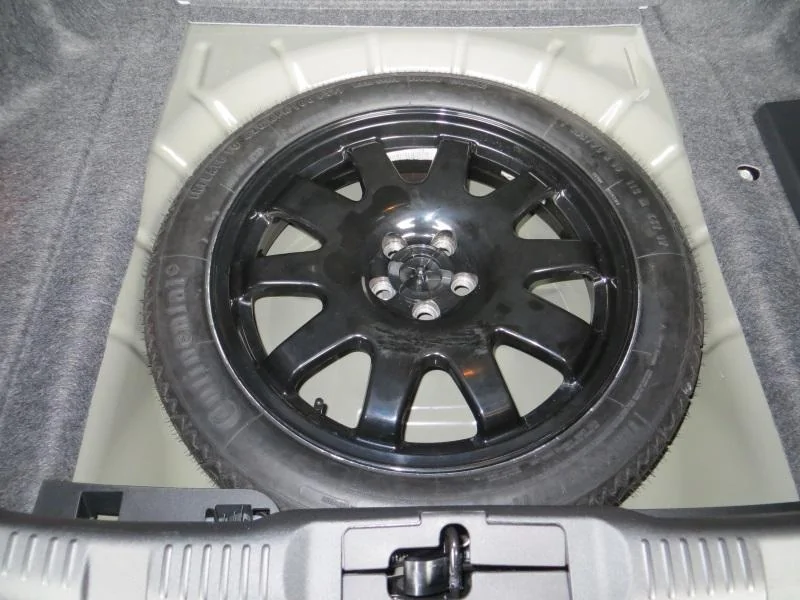

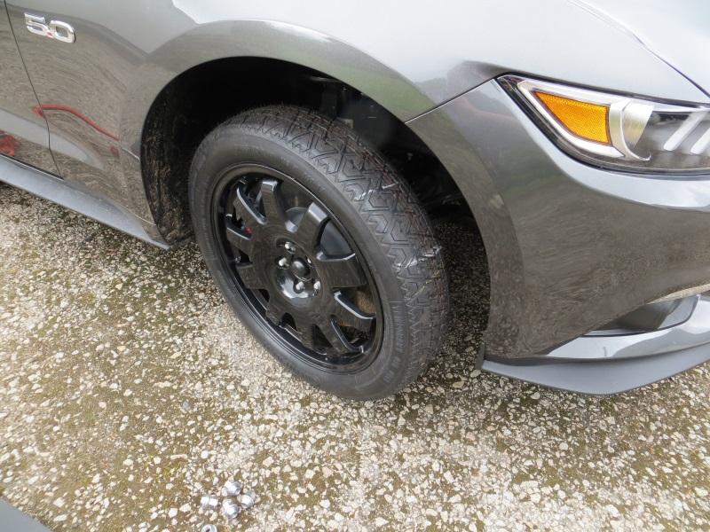

Fits in the wheel well:
Wheel is fitted with Continental 155/70 x 19 space saver tyre. This is 3mm smaller overall diameter than the rear tyre, essentially same size 275/40 x 19. Shouldn't be any problems with the diff.
Punters with non standard wheels and spacers may need to come up with your own solution.
Fitted wheel with mild steel washers torqued to 120ft/lbs. No apparent deformation of washer, unlike ally washers. Test drove 5 miles at speeds up to 60mph, mostly 50mph. No vibrations, no knocking, no rubbing. Wheel nuts still at 120ft/lbs when wheel removed.
