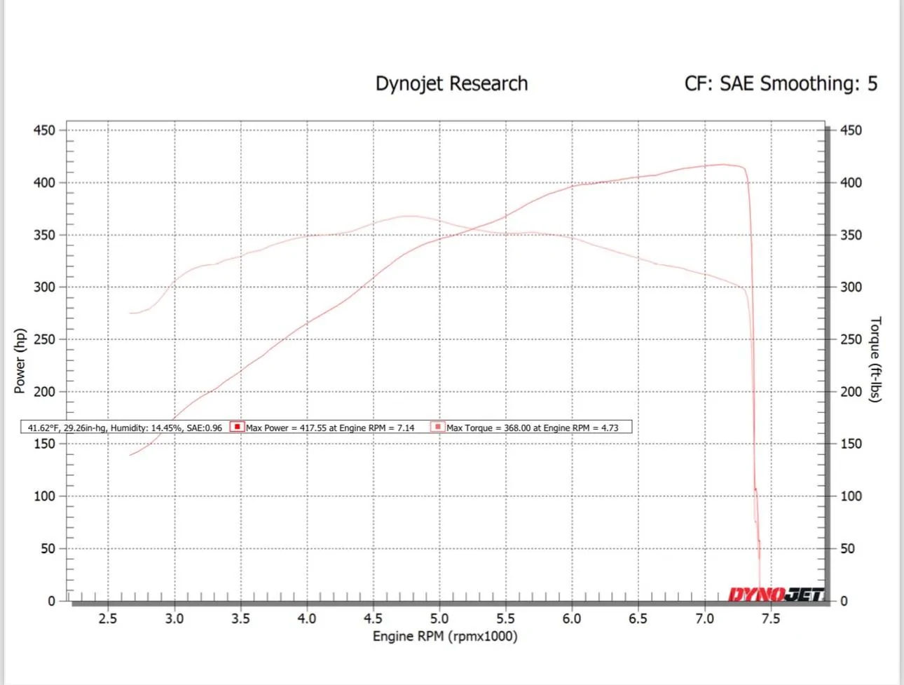

So I got the car to Kansas, and the first thing they did was Dyno. My car is stock except for the suspension. And I'm really glad I did the suspension first. I'll explain later. Here's the bsaeline Dyno:

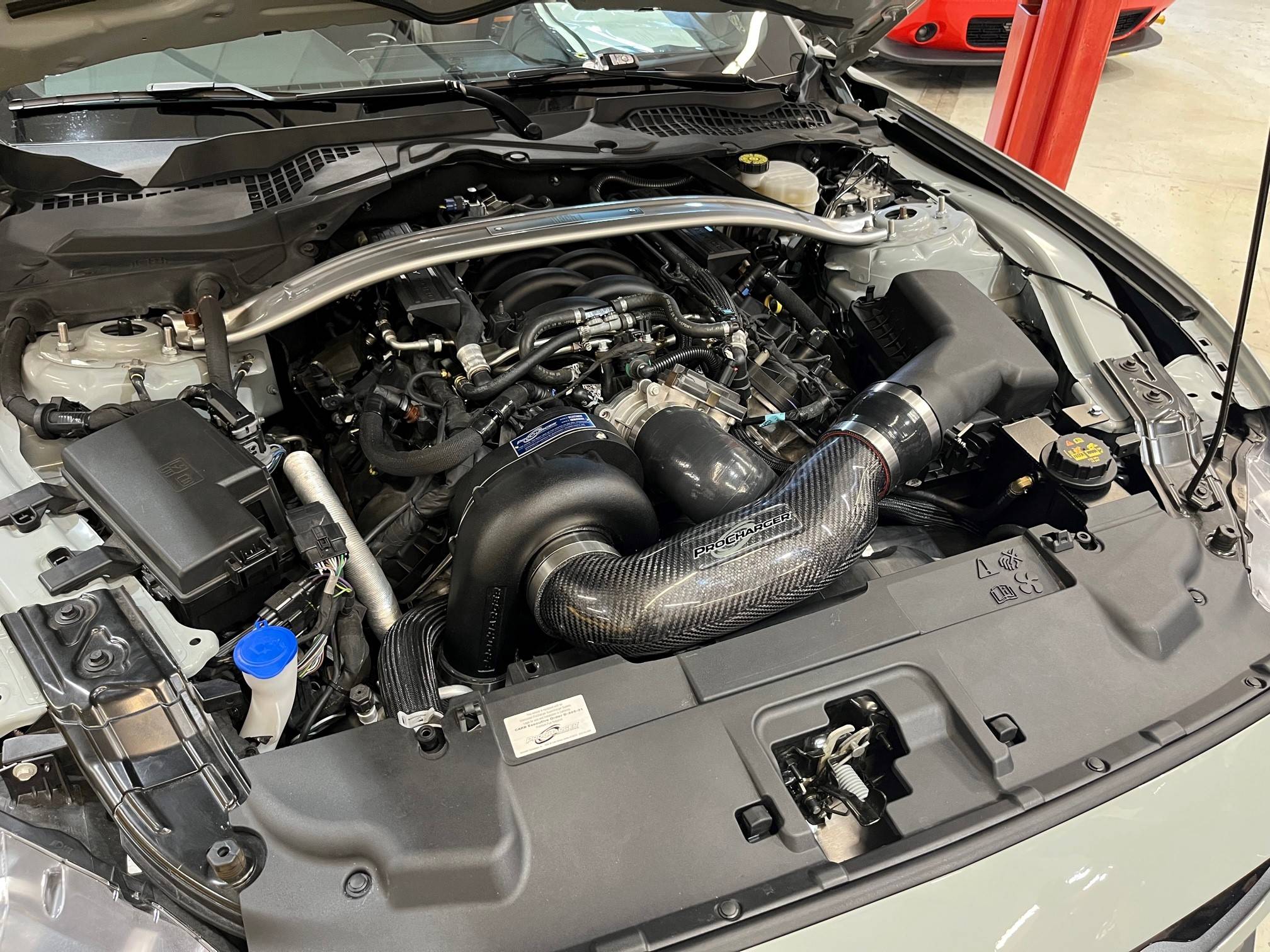

What I got Installed:
Stage 2 Kit, with P1-X, helical gears, and black finish.

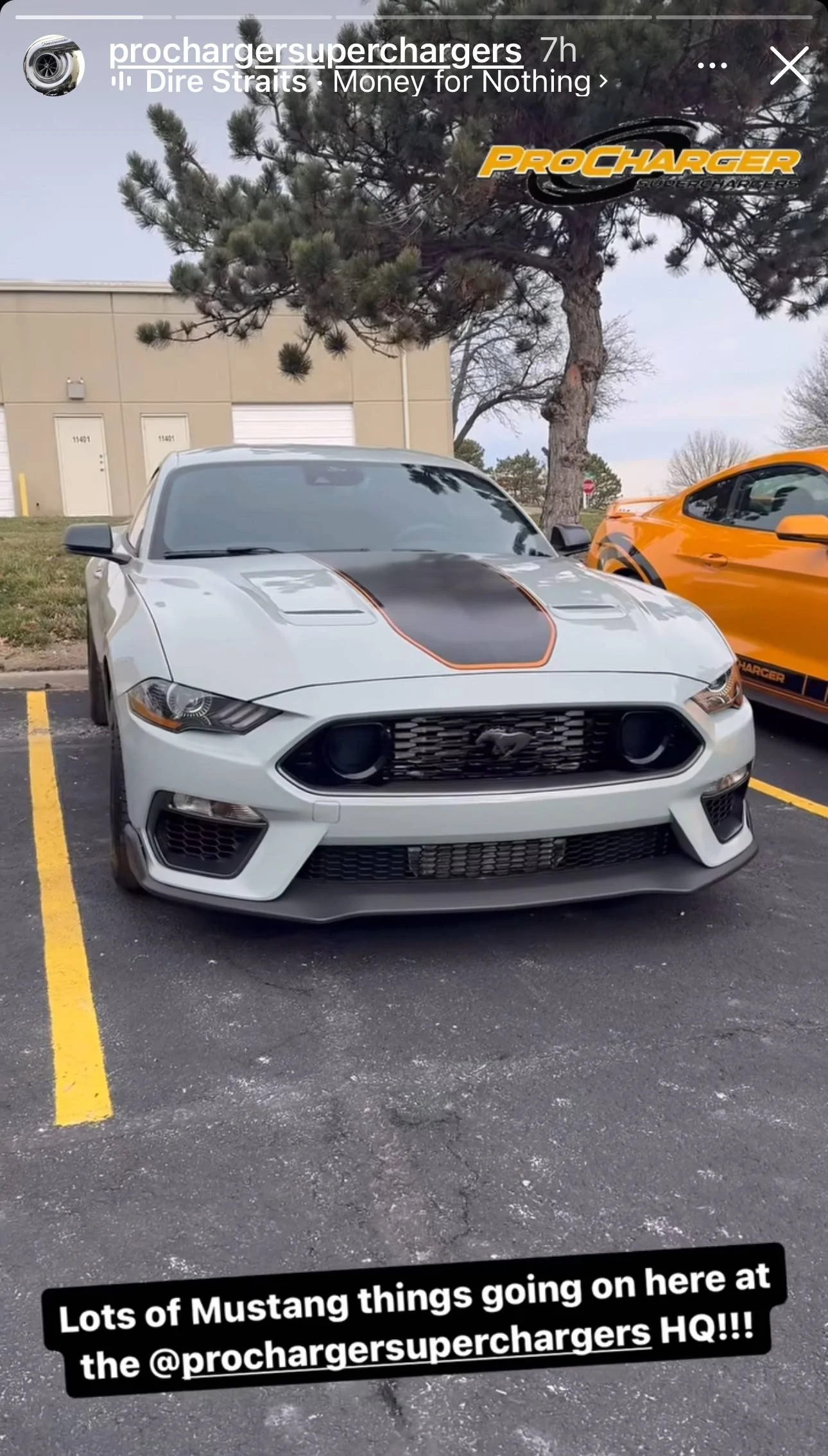

Then Install, and some photo shoots. Some of these are up on their website.

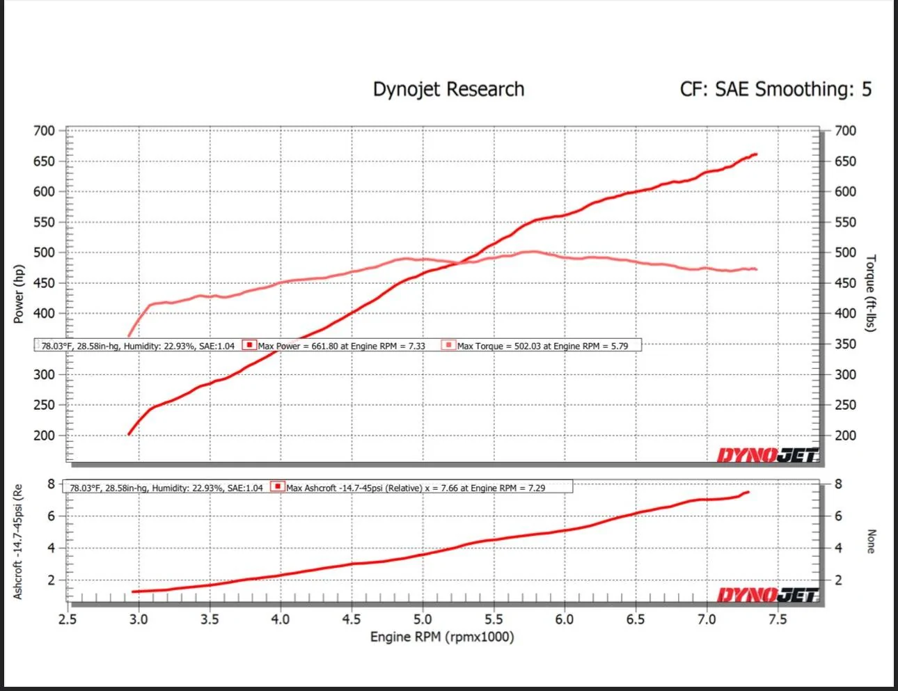

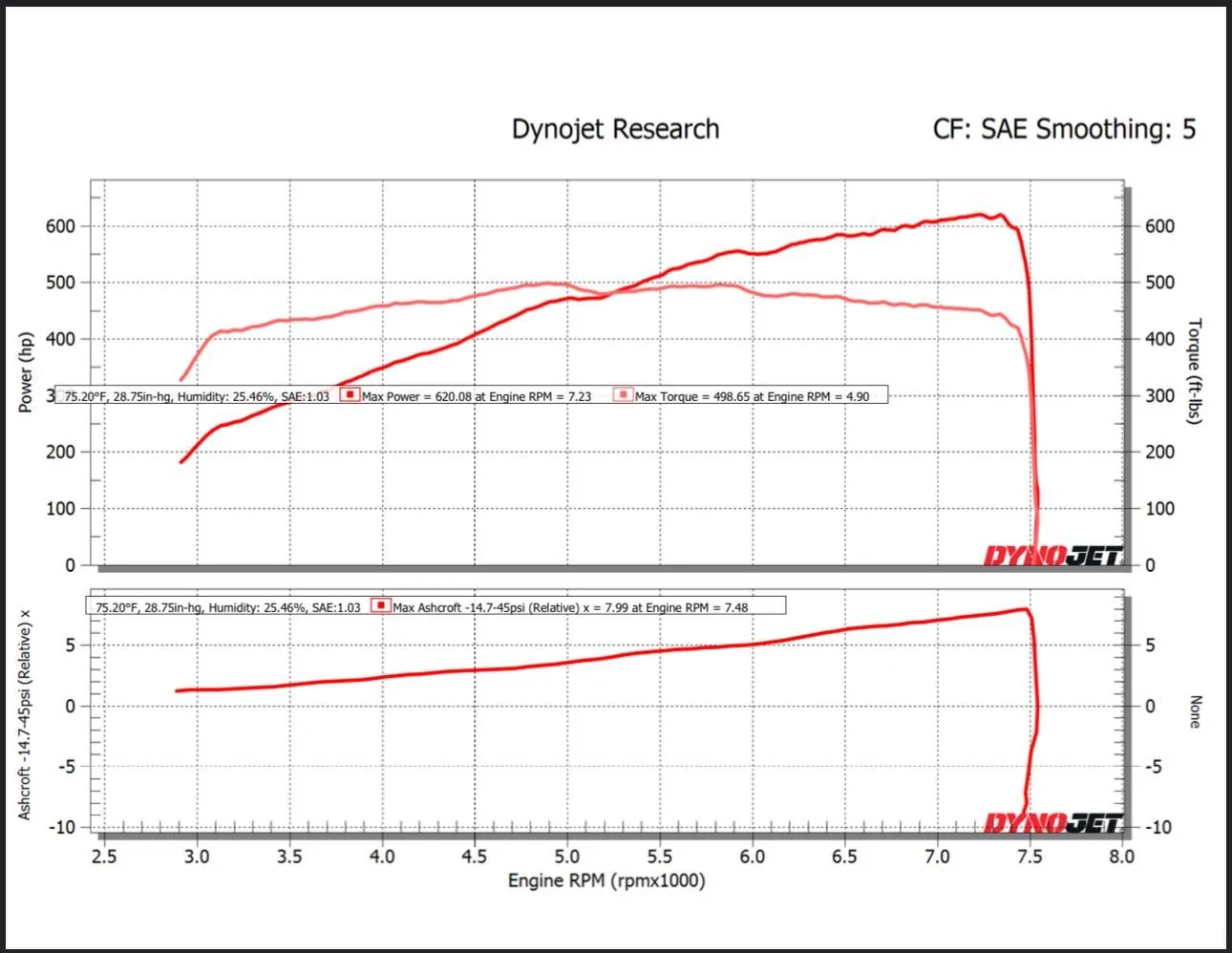

Then the tuning. I have two Dyno charts, where they started and where they finished.
My Impression, this car is so fun to drive. I loved it before, and it's even better now. I am not having any problems putting the power to the ground, even with the non-HP wheels/tires. I think the suspension has a lot to do with that. I had upgraded almost everything I could with Steeda suspension and am really glad I did. I got to enjoy this car right when I got it back. There's no wheel hop, and this car is so receptive to anything I throw at it. I'm really happy with the results. Procharger and those who I was in contact with, were very cool and patient with me. I did have a lot of questions and asked for pictures all the time.
