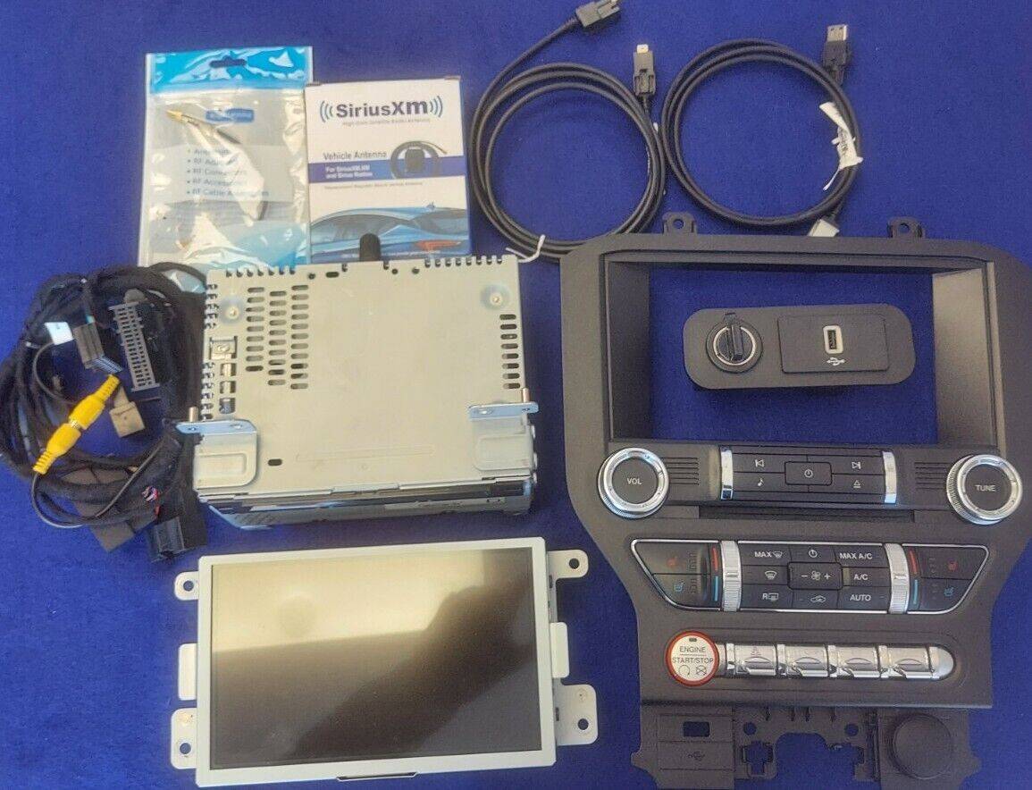

Mustang 4 inch screen to the 8 inch screen. Bought it from ebay (ThePartsFarm), the parts were from a wrecked mustang.
The following parts were used to upgrade:
The Upgrade is NON-GPS, the GPS Antenna was not included. So, I bought from amazon GPS Antenna (Eightwood company, working great). I followed a step by step video from Infotainment on youtube to upgrade my screen. I did not upgrade the ACM (Radio/CD), I left the original one.

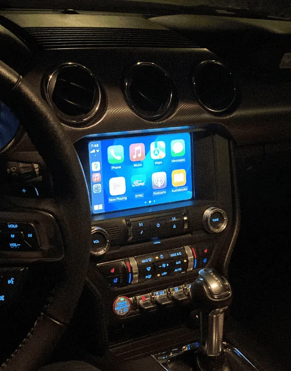

All in all, here is the final look:
Definitely worth the upgrade! Go ahead and do it.
