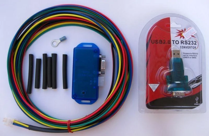

We've been told by MSD their unit works on the 15 but not on 16 or 17 models. With that said we recommend going with the WOT box as it will work on all years without any issues. We use the WOT box on all of our shop cars with great results.
[ame="[MEDIA=youtube]na7_tA2cxuc[/MEDIA]"]
If you have any questions or are looking to purchase a WOT box we have them in stock and ready to ship.
http://www.lethalperformance.com/n2mb-racing-dual-feature-wot-box.html
