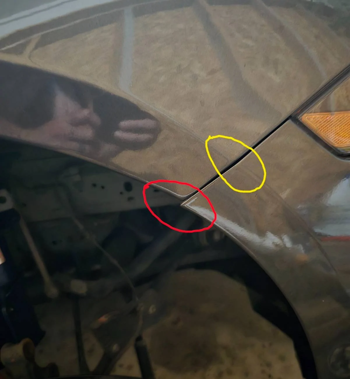

I bought the MP concept GT350 fenders. Driver side install went fine after I enlarged the opening so the fender vent would install properly. Passenger side was pretty much the opposite. Did not want to line up anywhere. After fighting with it for a while I was able to get it mostly lined up except for where the fender meets the front bumper. In the pic below the body line (circled in yellow) is lined up but at the wheel well (circled in red) it seems the fender was not made wide enough. Not sure what can be done to correct this. The angle on the picture made it look better than it actually is. Thought maybe installing the Mach 1 fender flares might help hide it but not sure. Any ideas

Only practical path is 40 gt rotary grind number leading edge line to follow fender line then do the M1 trim or repaint the bumper. It's a quick and durable fix. Be sure to multilayer mask adjacent fender first.
