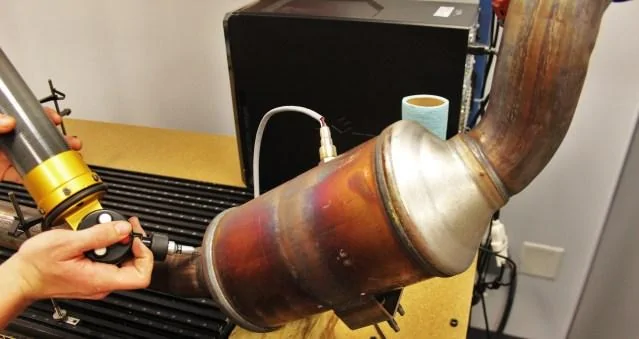

The fact that you guys are using 3D printers to help develop this downpipe is bad azzz
