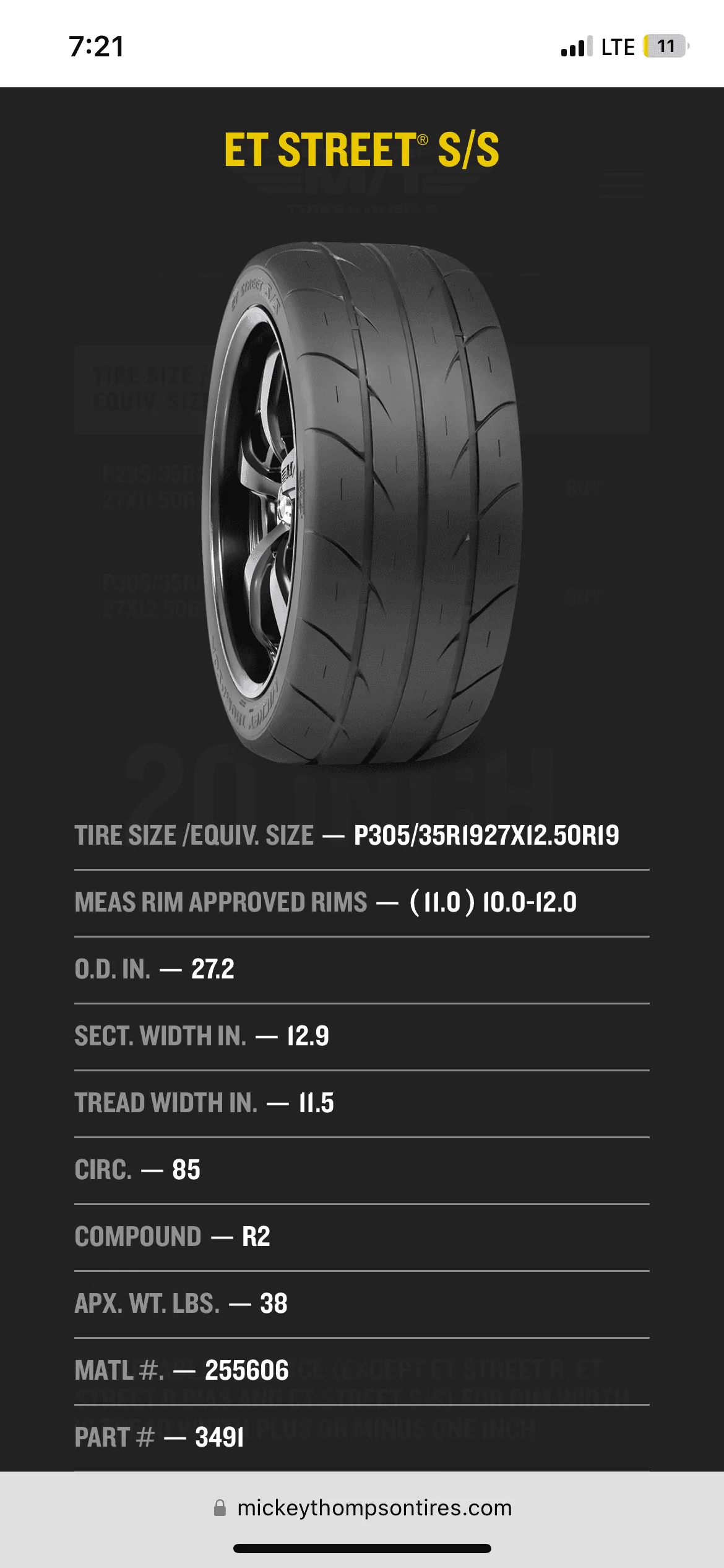

will these ET strees S/S fit the OEM 19in GT350 rear wheels?

I have zero experience with these but it looks like it will fit just fine.
That said, isn’t that more of a drag tire?

It will fit on 10-11.5ā€ wheels perfectly.
It’s more of a street tire than drag tire. Like 70% street, 30% drag strip. Drag radial R compound, with stiffer sidewall weight and construction and useable tread.

Thanks my car is set up mainly for roll racing. I think these will be a good fit for me. I’m coming from the Toyo R888R and see these as a better option.
Yeah. R888R’s blow elephant turds. They are OK for heavier AWD platforms though.

Honestly buying those Toyos was such a waste of money. It’s funny too the R888r’s get so much hype online but they really didn’t work that well for me.
