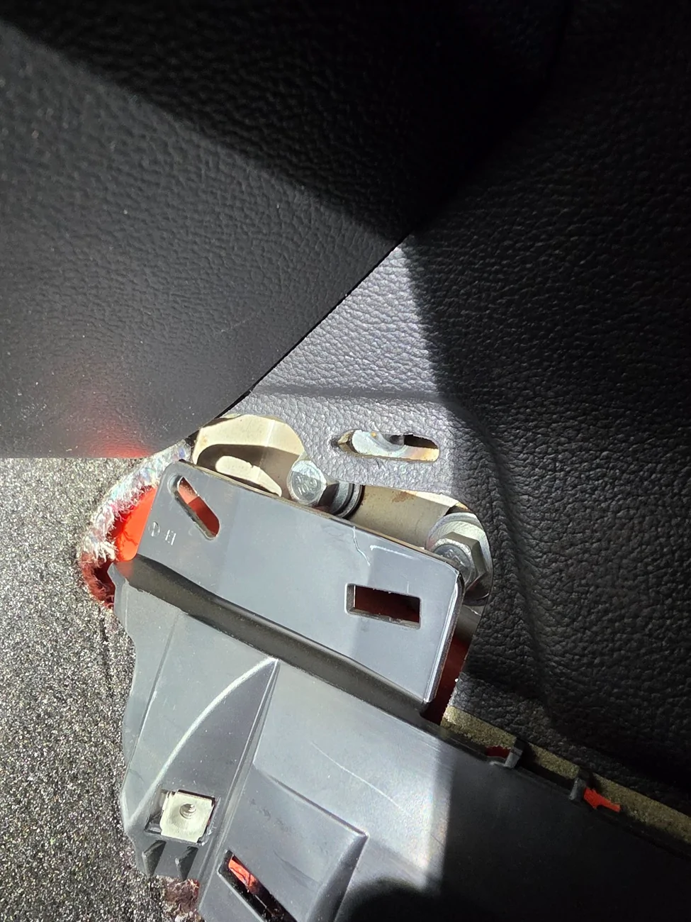

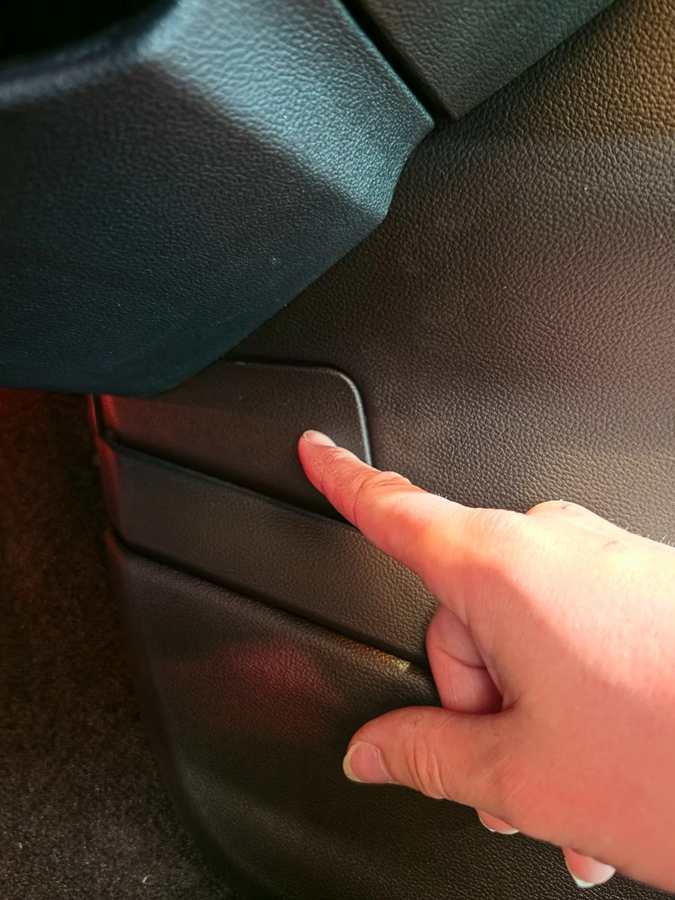

Found the noise in my car as well. The bolts behind this cover are loose. Best described as "keychain" jingle noise. Hopefully this helps others!
