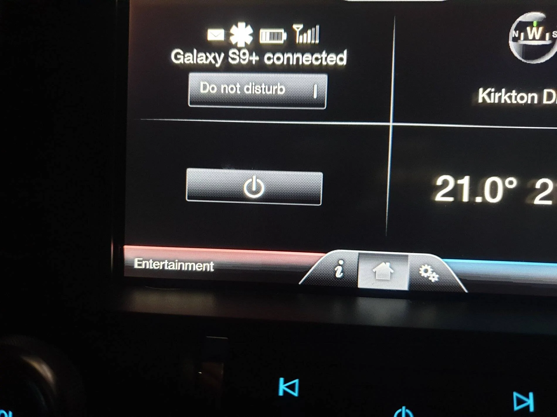

Hey, I just want to check im not being thick but yesterday I started my car up and the media was switched off. For some reason I can't switch it back on. Because of this I cant use my radio but it still works with Bluetooth audio. Is there a setting or something that might stop this from turning on? I have tried the touch screen button which beeps but does nothing, and the button in the center console below.

I thought there was a physical button to turn the audio on, too, no?
Just below your photo there. I am guessing pressing that did not turn it on either?

Yeah I have tried that too but nothing happens

So today while the car was running and playing music from my phone I turned my phone Bluetooth off. The car then automatically switch to AM radio. I still wasn't able to change radio stations or switch to FM radio etc. I turned the car off, turned it on and then I had absolutely nothing on the media system. Could be the media system is just knackered... (sigh)

Disconnect the battery, have a cup of tea, then reconnect.

Just tried that and it worked! Thanks. Slightly embarrassed I didnt think of it first though.
