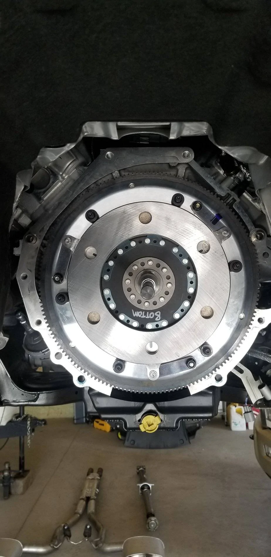

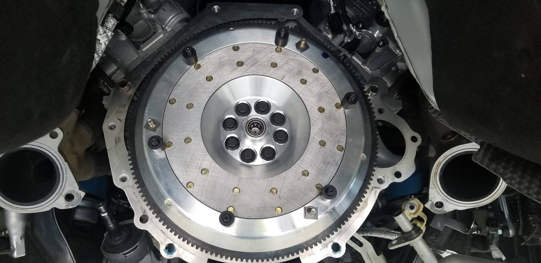

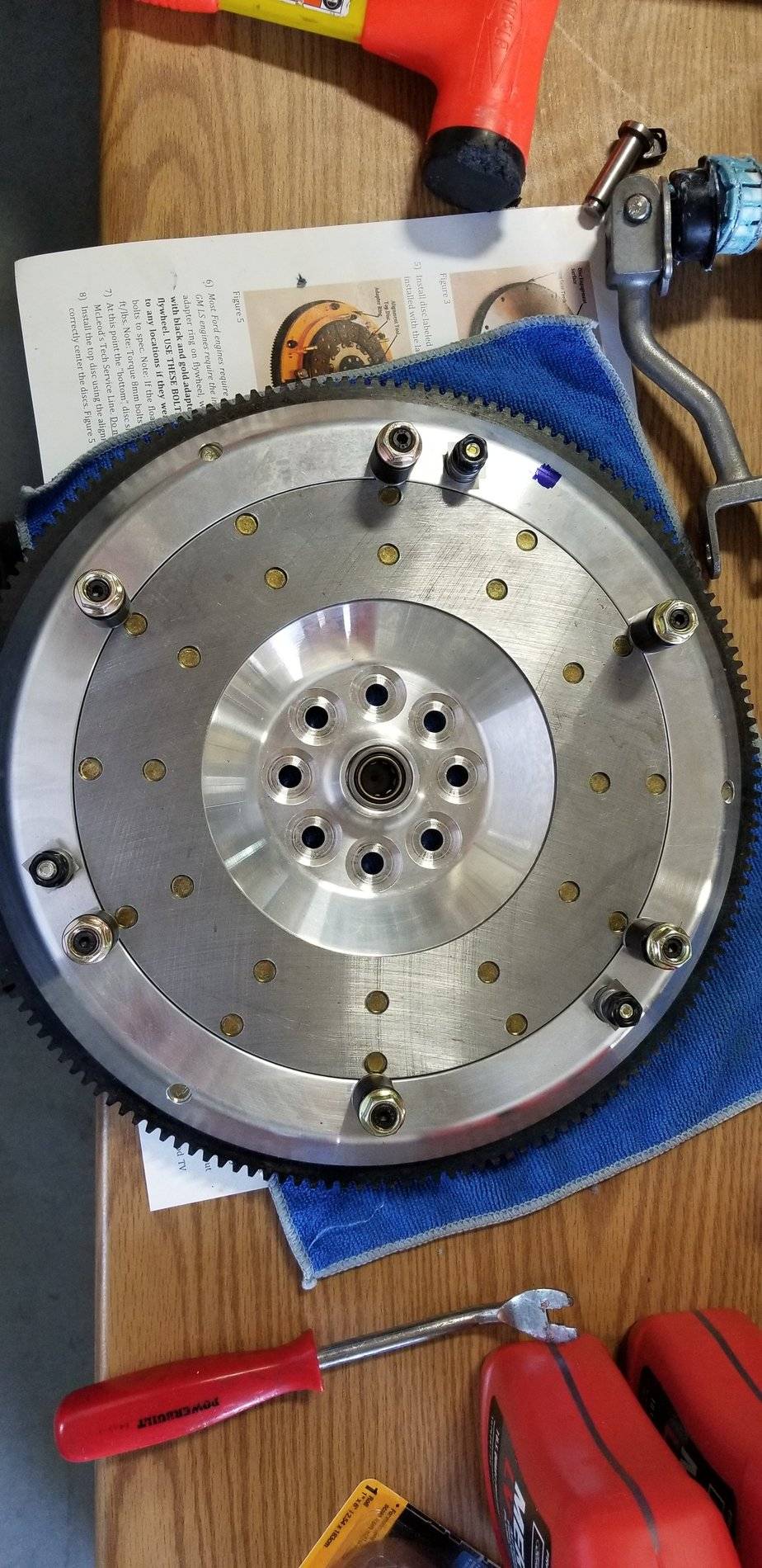

Any chance that someone here would have any pictures from a clutch install that would show the part number off their aluminum flywheel? There is a local guy selling an RXT1200 clutch kit for a good price that "supposedly" came from a GT350 but the part number on the flywheel is 563408 008-516 which appears to be for a standard 5.0L. I was under the impression that the Voodoo crank is zero balance for the high RPM so I want to make sure this is the correct part for my engine before I buy a part I can't even use. Thanks, Chris

Here are some pictures of the RXT on my 350. I don't remember the flywheel itself having any identifying numbers on it anywhere but maybe the pic will be enough to help.

EXCELLENT!!! This is exactly what I was looking for. This is definitely a different flywheel that what this guy is selling. When I addressed it with him, he fessed up that it did in fact come out a 5.0L GT. Thanks for the pics. The previous owner of mine removed the RXT clutch a out of mine before he sold it so I am running on borrowed time with the OEM clutch right now.
