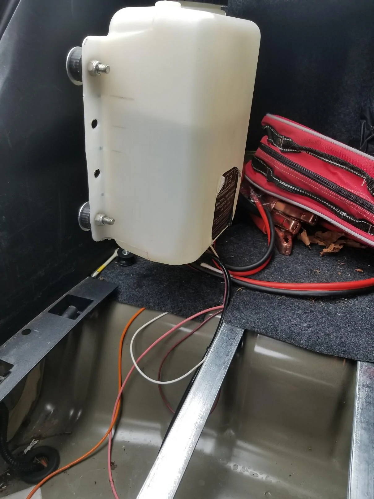

I tell ya what though, I love how his meth setup is mounted in the bay like that. I will be doing the same with mine now haha.

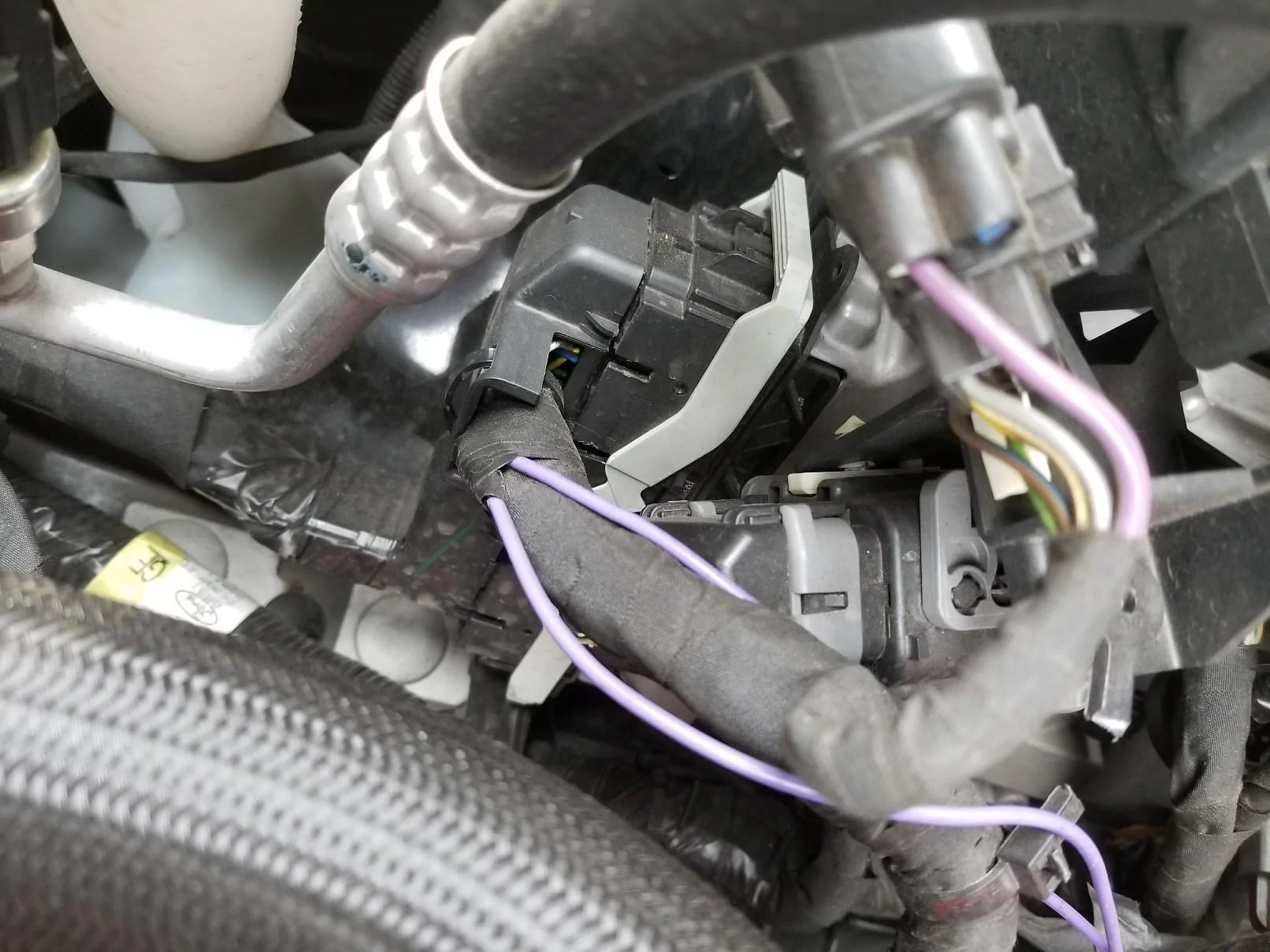

If you tell me how to add a picture to this, I'll show you mine. I soldered it to the throttle wire. Opens connection, no throttle

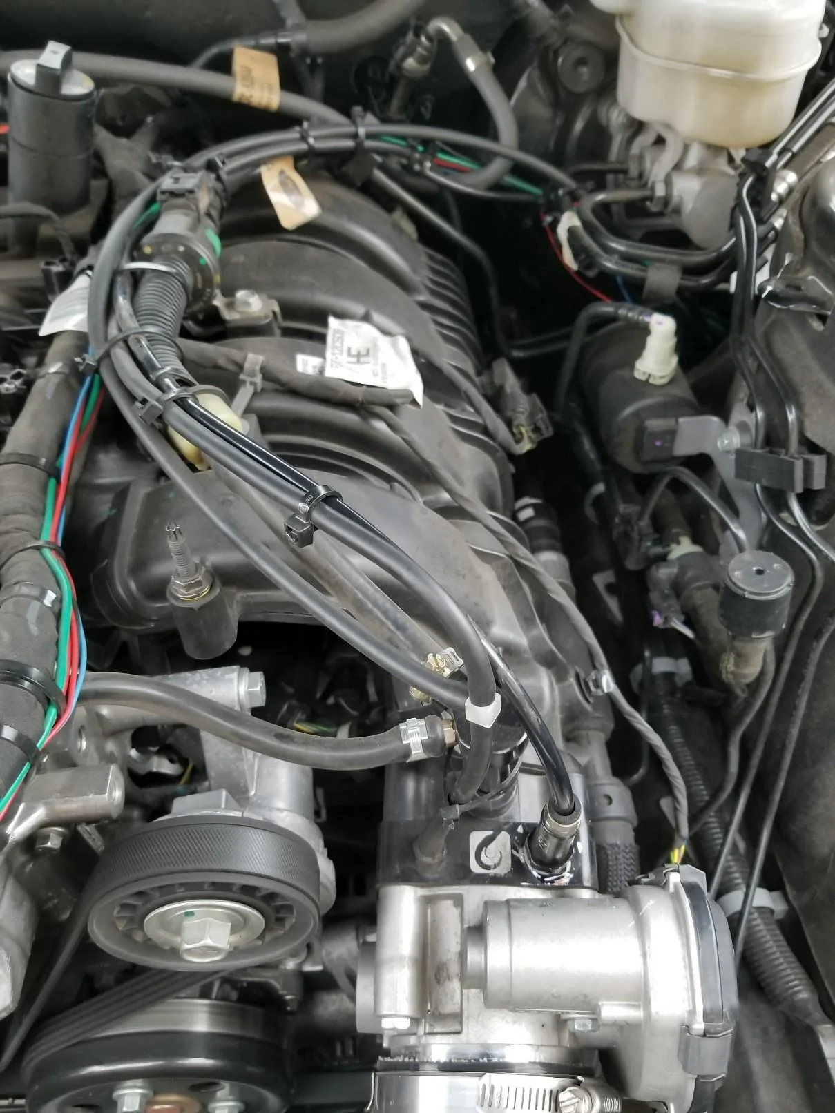

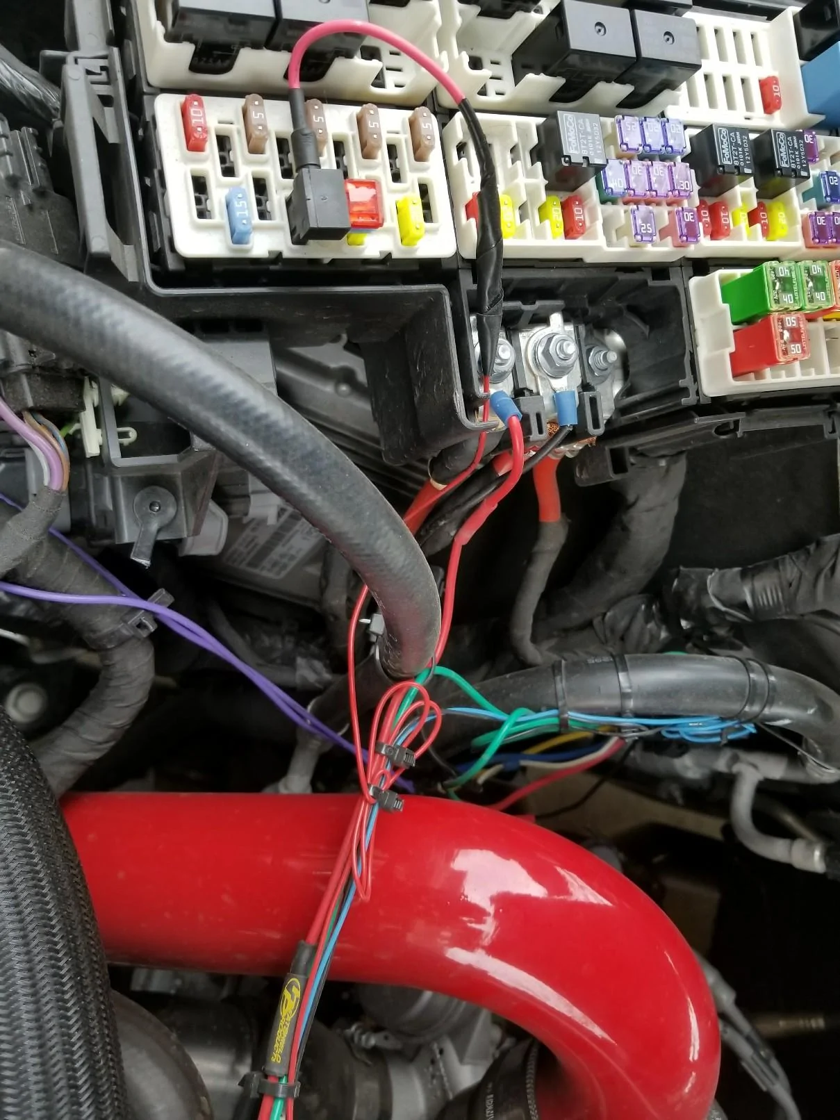

From my photos, those purple wires are what runs to my ecu box. There's a yellow and purple wire that is the throttle control. Splice, solder, heat wrap and taped. If switch is off, low fluid, fuse, or wire issue presents, I lose throttle. Also have an AEM AFR gauge to watch as well.
