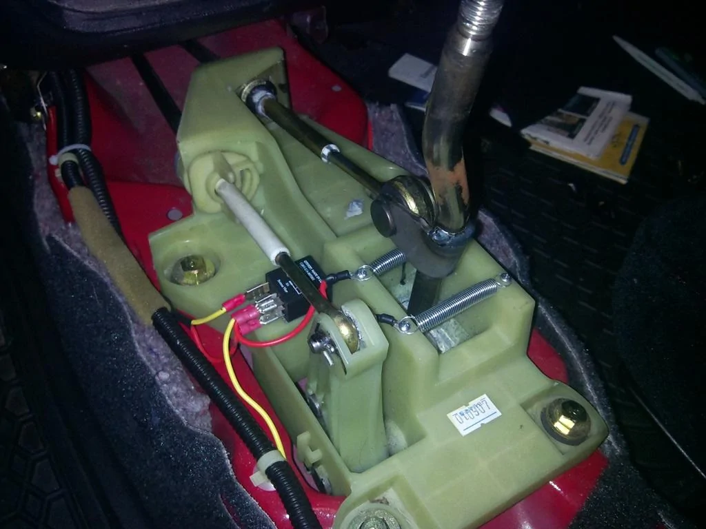

Here's the basic idea done with IR instead of wire.
http://www.eeinspired.com/NSS.html
This can also be done with springs and simplified a bit.
Not a mustang (obviously)
I've also seen people use a magnet and switch on the actual linkage so that the stick must be in center neutral for the circuit to complete.
This. When I was an installer back in the early 90's, I used home alarm magnets. wired it like a neutral light on a motorcycle. depending on the transmition, it was usually pretty easy.
We would not install it for any customers, but most of us did it to our own car.

I've had a remote start on my manual car for 12yrs and it has never remote started on me in gear. The trick for my car is it has a neutral safety wire at the transmission that reads ground when in nuetral and an open circuit when in gear. The remote starts neutral safety wire connects to it so any time is in gear it won't start. Most cars don't have this wire so have to make gate or switch around the shifter. I've done this using mag switches or ball bearing switches which aren't 100% reliable. The best way I've done that hasn't failed on me yet is grounding the shifter rod and making a spring gate around the shifter that connects to a relay then the nuetral saftey wire of the alarm, basically making a nuetral safety switch similar to the pic above from [MENTION=11725]drbrian722[/MENTION].
But at the end of the day there's always some risk if it's not done right. Not every installer is created equal!!!!!
