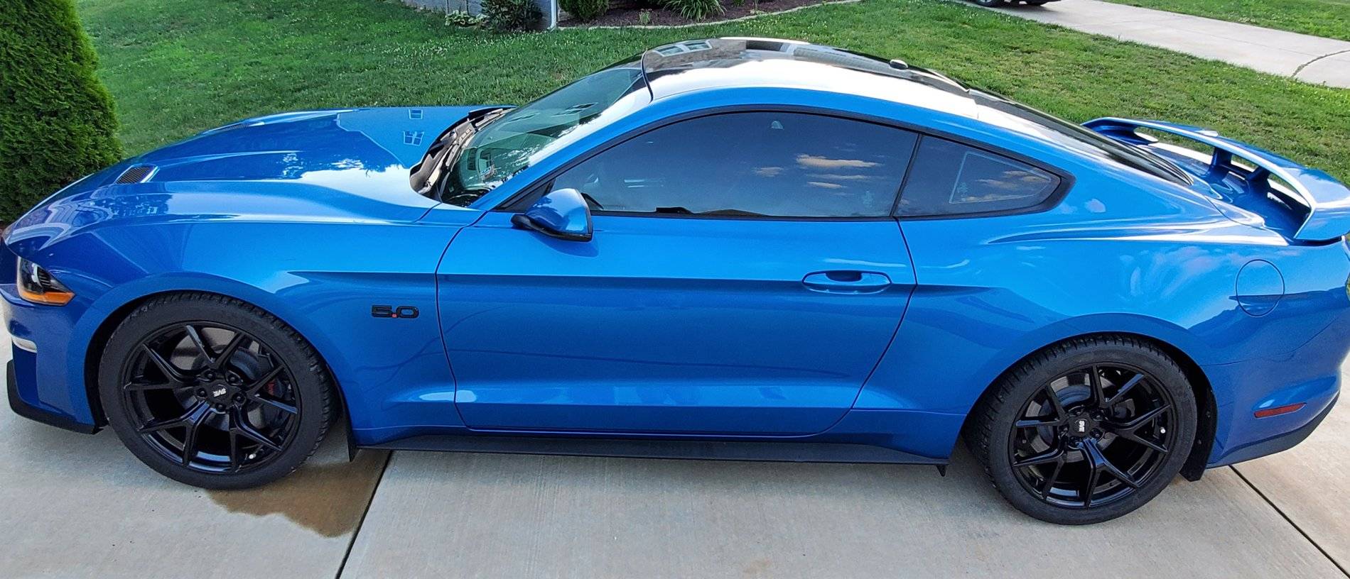

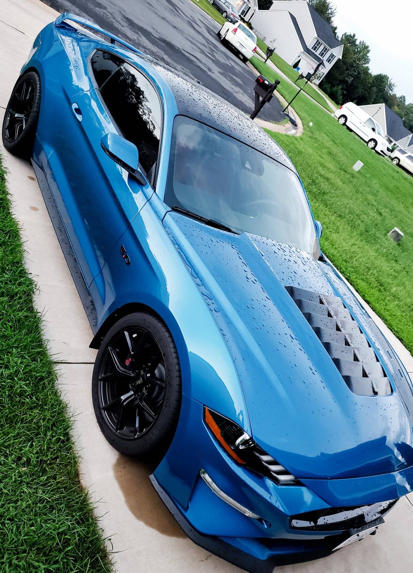

That's great looking Mustang!
What tire sizes?
Is the fender gap even front and rear?
Rear is 325/30/19
Front is 285/35/19
Here is side shot
