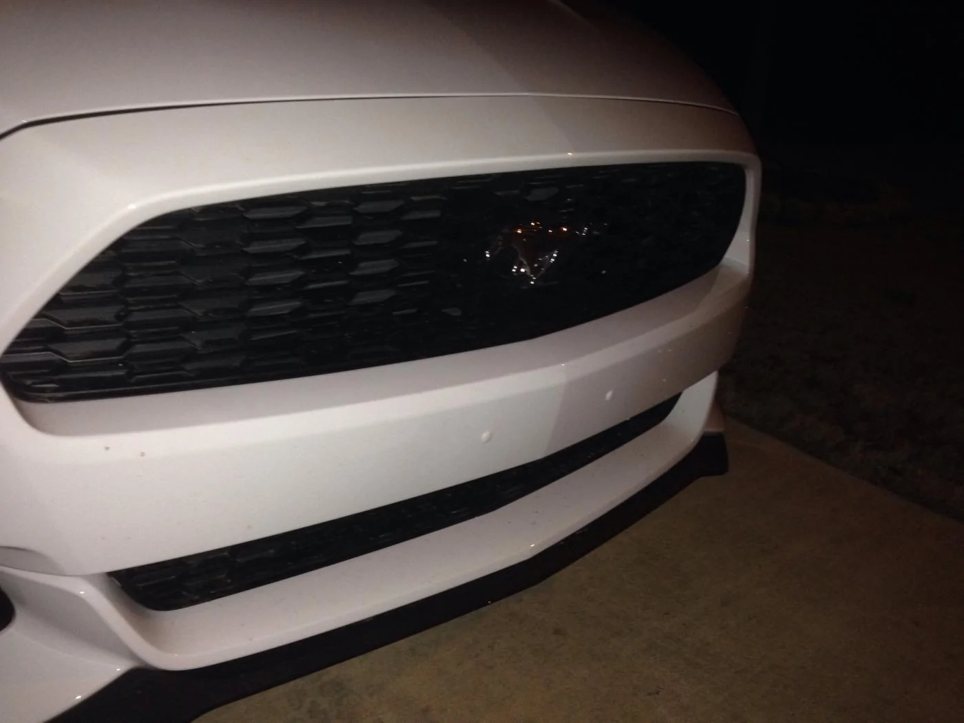

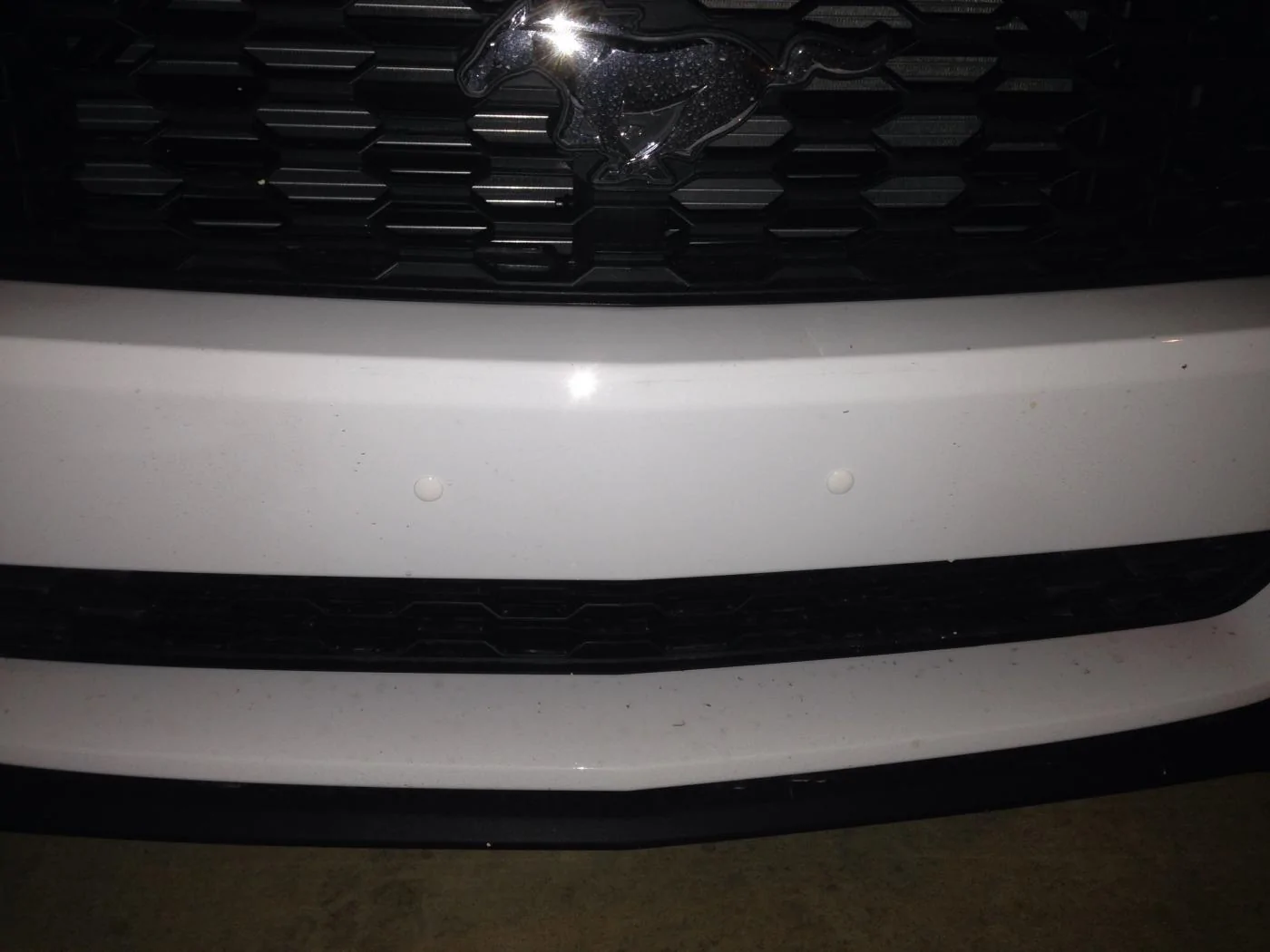

I am going to try and fill the holes with bumper repair epoxy, prime and paint them.
2 issues with mine though: The guy who drilled the holes did a crappy job and the holes dimple out about 1/8 of an inch from the bumper. They also screwed on a cardboard dealer ad plate that, because it was not at thick as a metal license plate, the screw went right into the bumper and that needs to be fixed as well.
I will post pics of the current state and the progress of the repair when I get to it.

My bumper was pulled out too because of the screws. I used an xacto knife and bevelled the edge, basically countersinking the hole, cutting away the bulge. the pins laid perfectly flat and tight to the bumper after that.
