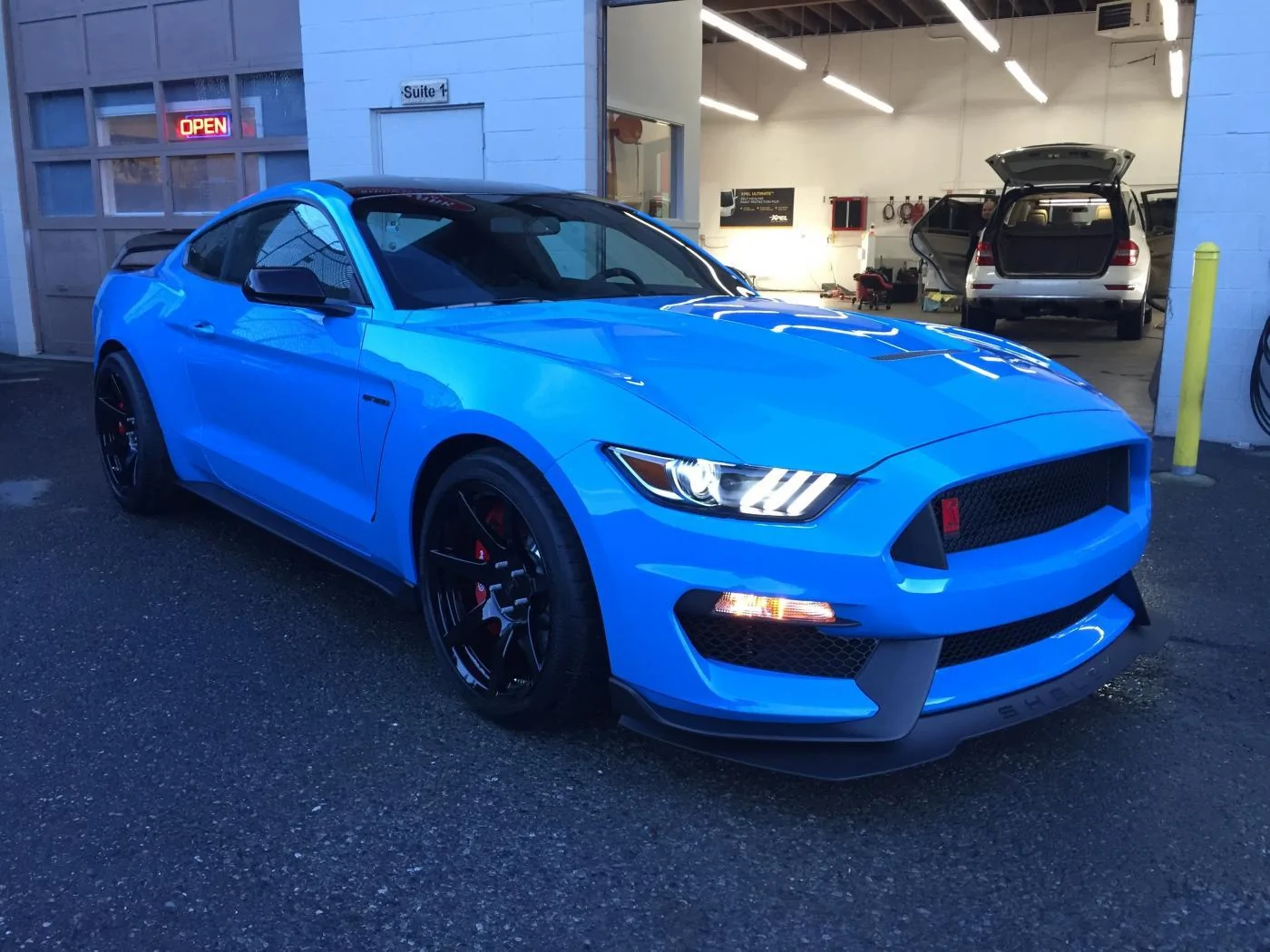

I just got the "kit" from N4SM with the open nuts.

GA1R open lug with cap. Thought about other FL monoblock wheels but few are load rated for R comp tires. I track this car and want strong wheels that will handle loads while still looking great. This is not a car you want to throw on non load rated wheels and hit the track hard. Will it work?..yes...until is doesn't. The latter makes for an ugly day. My .02

I'm thinking of the Ga1R Forgelines as well. I love the R wheels and will try to change them out with MPSS first.

I really don't mind the studs or the exposure, they are what the car came with. When I put the stock wheels on for track duty wouldn't one want to keep the stock studs if any potential warranty issues were to arise?
I agree w/JN66 - I'll wait till there is a legitimate solution not a bunch of cosmetic solutions and potential downgrading/engineering to solve an exposed stud that is in fact stock/OEM.
Again, to each it's own and doesn't bother me one bit. It's not a show car to me.
There may be a rust problem with exposed studs. If you keep them clean, it shouldn't be a problem but watch out for rust.
Hmm, ok... but you've already "downgraded" the car's stock engineering by adding the 6g wheels. I can't begin to tell you just how many times stock studs fail...
You can bet on this though... when I do replace my studs, the dexterity of the studs I will be going with will match or exceed the stock stud capabilities.
Wheels not too concerned, just for winter/street use. . Not track.
Freeway speeds at a max, residential speed bumps - think I'm all good with the 6G wheels until Summer.
As someone in the industry of service, particularly mechanical . . studs play a major role and are not something you just swap/put in without a lot of engineering to back them up.
Studs/nuts are not a cosmetic item as some seem to prioritize on this thread.
We all have or own taste, so let's just leave it at that. Some aren't happy with the stock wheels, shifter and a slew of other things these car came with - and that's fine by me, to each their own.
