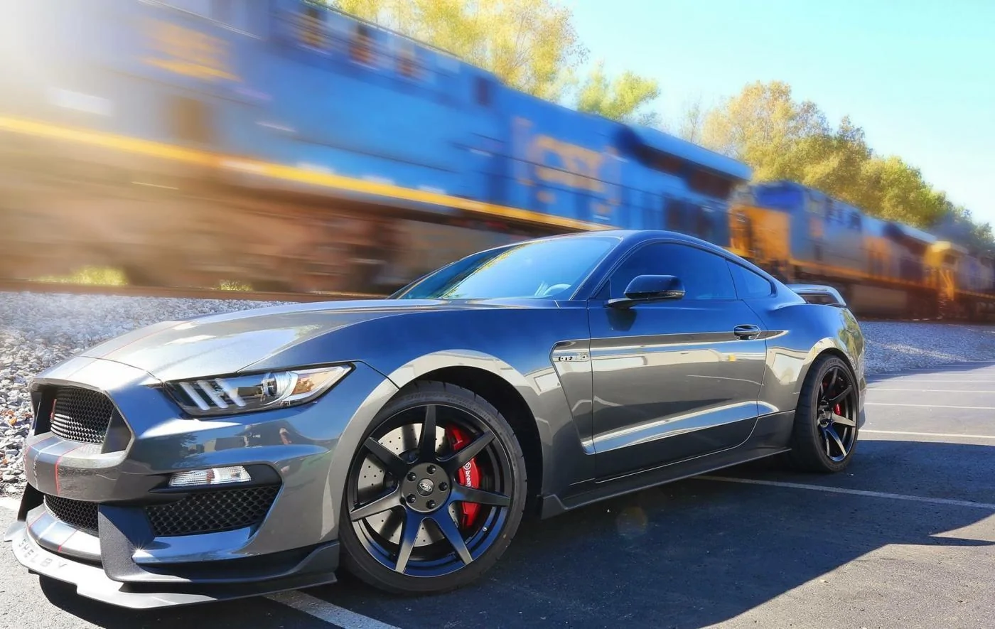

Relax man, you sound injured... we're simply discussing lug options here. It's actually good that you posted a pic of your car with the 6g wheels so R owners can see what they will have to face when trying to use that setup as an alternative.
The studs on these cars were matched in length to the needs to accommodate the CF wheels... why should I argue with anyone about that? I'm just not one for putting around town in such a fine piece of mechanical art only to have the studs steal the thunder. It's your money but damn those exposed studs are hideous and are a focal point of ugliness.
I am merely here to offer a solution to the problem the OP is concerned with... and I should have that solution very soon. I appreciate you posting your pic so we can see the need for such a solution.
