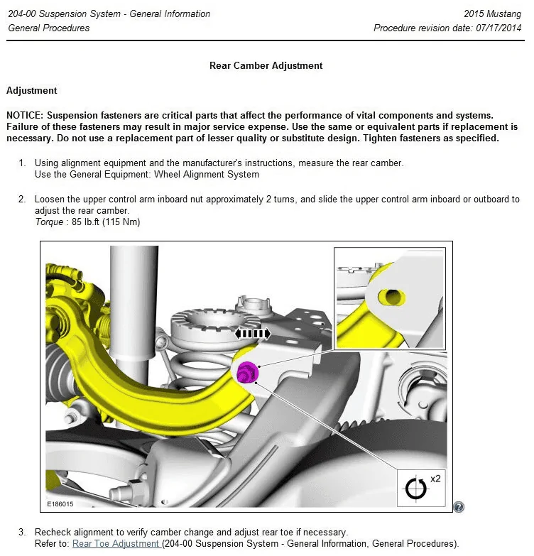

Steeda Camber Plates and rear Adjusters.
Rear adjuster are not necessary just make dialing in the rear a little easier by using an eccentric vs a slotted hole. more of a benefit for your alignment tech.

Is it the rear camber adjustment kit or the adjustable arms?
