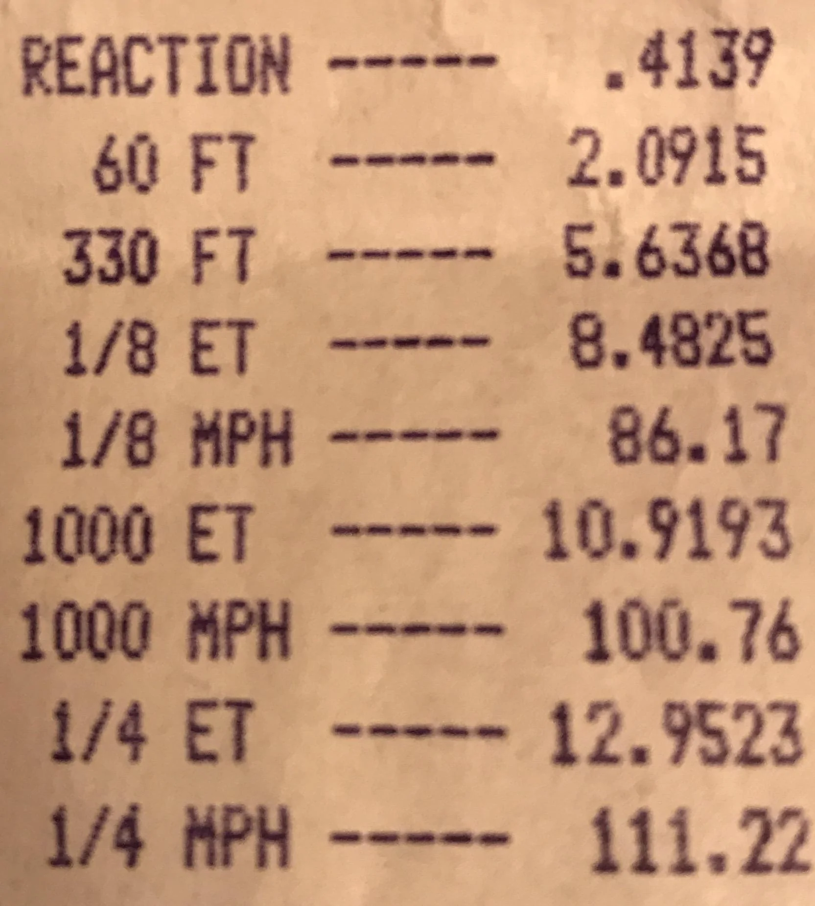

Ok update to this thread:
Dropped the bama tune for a Lund tune. Went to the track tonight and here were the results. I bested my time but mph is still low. On the way home though, it dawned on me that maybe I should be shifting into 5th with my 3:73s. I noticed that I was at about 7000-7200 Rpms in 4th when crossing the line. Could this be the problem? Am I losing a few mph by doing this? Does anyone else shift into 5th with 3:73s besides the FI folks?

Stay in fourth! Fifth will kill your et and mph. I have 3.73 and w 430whp went 12.20@ 117 in good air in fourth. Now with updates and going to track once on better tires 11.7@120 on bad air, still crossing in forth.
Then something is really wrong with my car. Two different tunes now and still trapping at 111.

I see your in Ohio also, I'm thinking Kil-Kare and you posted at 9pm, so if it was tonight, say at 8pm, track elevation of 910ft, temp 82.4 and 29.96BP with humidity at 54 percent is a DA of 2883 with a relative density of 91.97.
Your [email protected] corrects to [email protected].
Yes it was at kilkare. Weird though because I see people post better mph with same DA. I may just have to put it on a dyno. Where are you in Ohio? Any good places to get a dyno?
