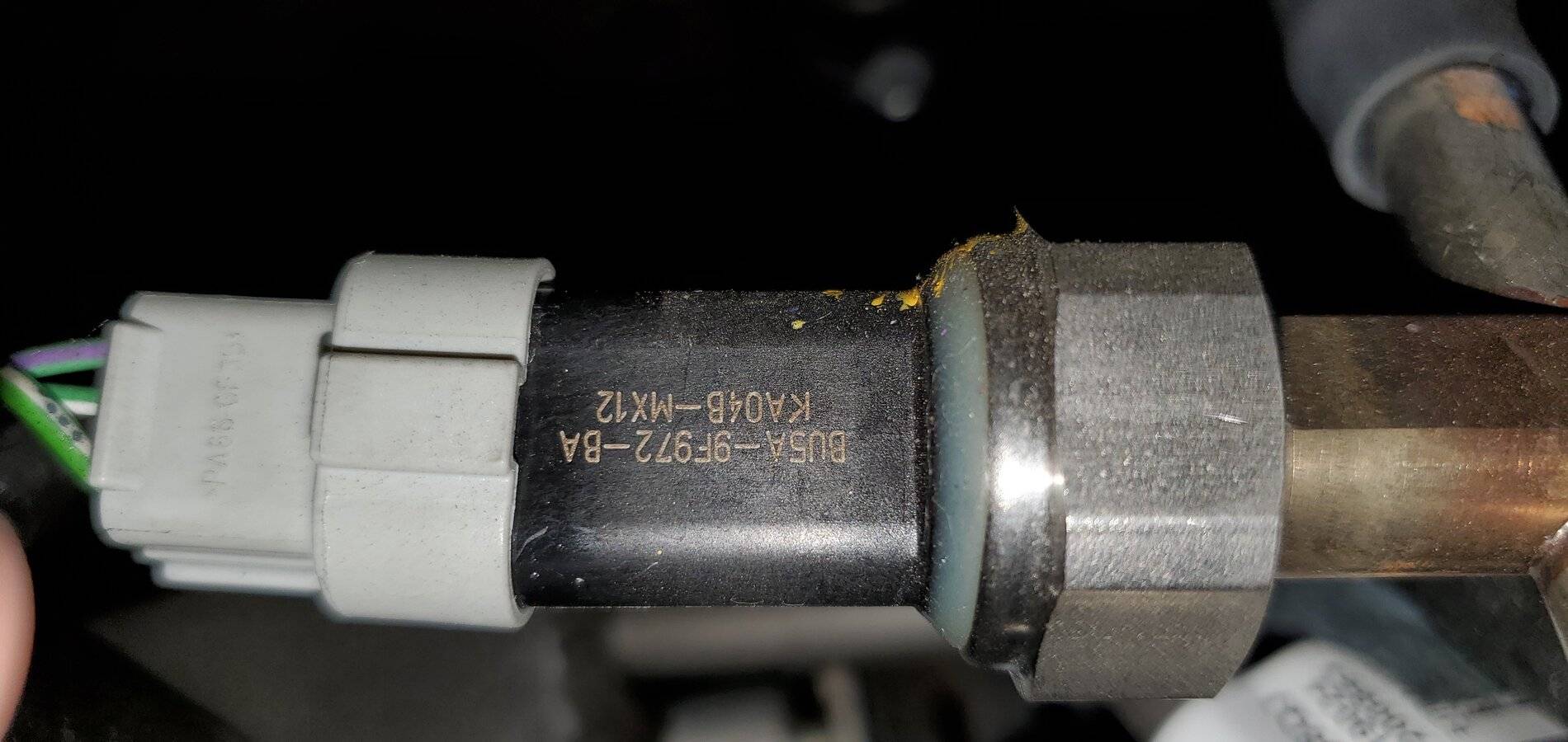

I wanted to share my story incase others run into a similar problem.
Few days ago I noticed my launch control light flickering off and on. Didn't have any check engine light.
I've read through many forums asking questions about LC and similar problems with it flickering or not working at all.
I noticed the fuel pump priming noise (rapid fire) when opening the driver door sounded different (wining sound) and a slight reduction in performance.
I got a code P018c on my odb reader. So "engine off" I tried reseating the connector on the low pressure fuel sensor and the (LC) light came on solid for a while the started flickering again. I've done this a few times, but it finally went off and stayed off.

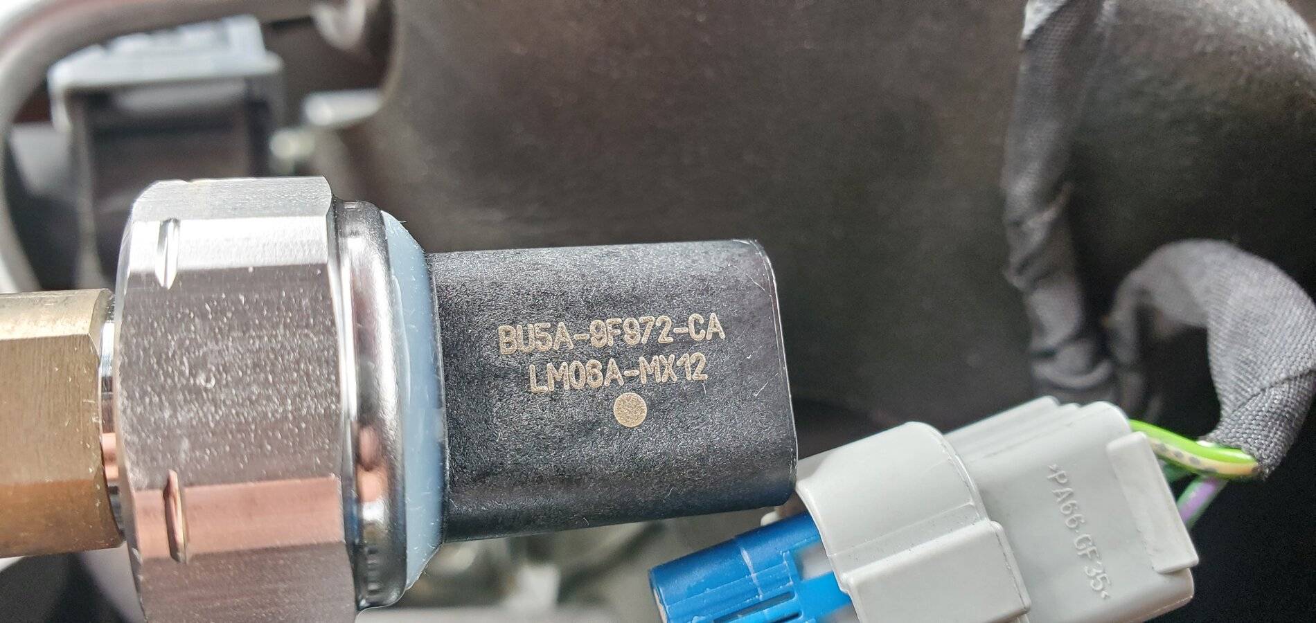

Today I replaced the low pressure fuel sensor BU5A-9F972-BA with BU5A-9F972-CA.
Cleared the code and started the car. The fuel priming sound is back to the rapid fire sound. My LC light stays lit after reaching 175f and the car is pulling stronger.
I read forums and seen videos about replacing the sensor early on to prevent the ECOBOOM.
So, anybody else that has launch control flickering off and on without check engine lights. Plug in a reader and check for the p018c code. Replace that sensor.
