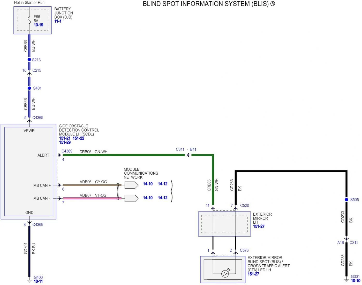

The light that is inside the side view mirror, would love to tap the wire that triggers the light and recess a small LED on the inside mirror panel (plastic cover-inside of door) to have a secondary illumination point. Would provide a better visual point rather than all the way out on the mirror.
[IMG_2573.jpg](https://postimg.org/image/8mlr376yn/)

I think he's talking about the blind spot indicator.

If you're looking for the Blind Spot Monitor wire, it is green/white on pin 11 and the return is black on pin 7. Here is the diagram for the driver's side, The passenger side is brown on pin 11, the return is black/white on pin 7.
