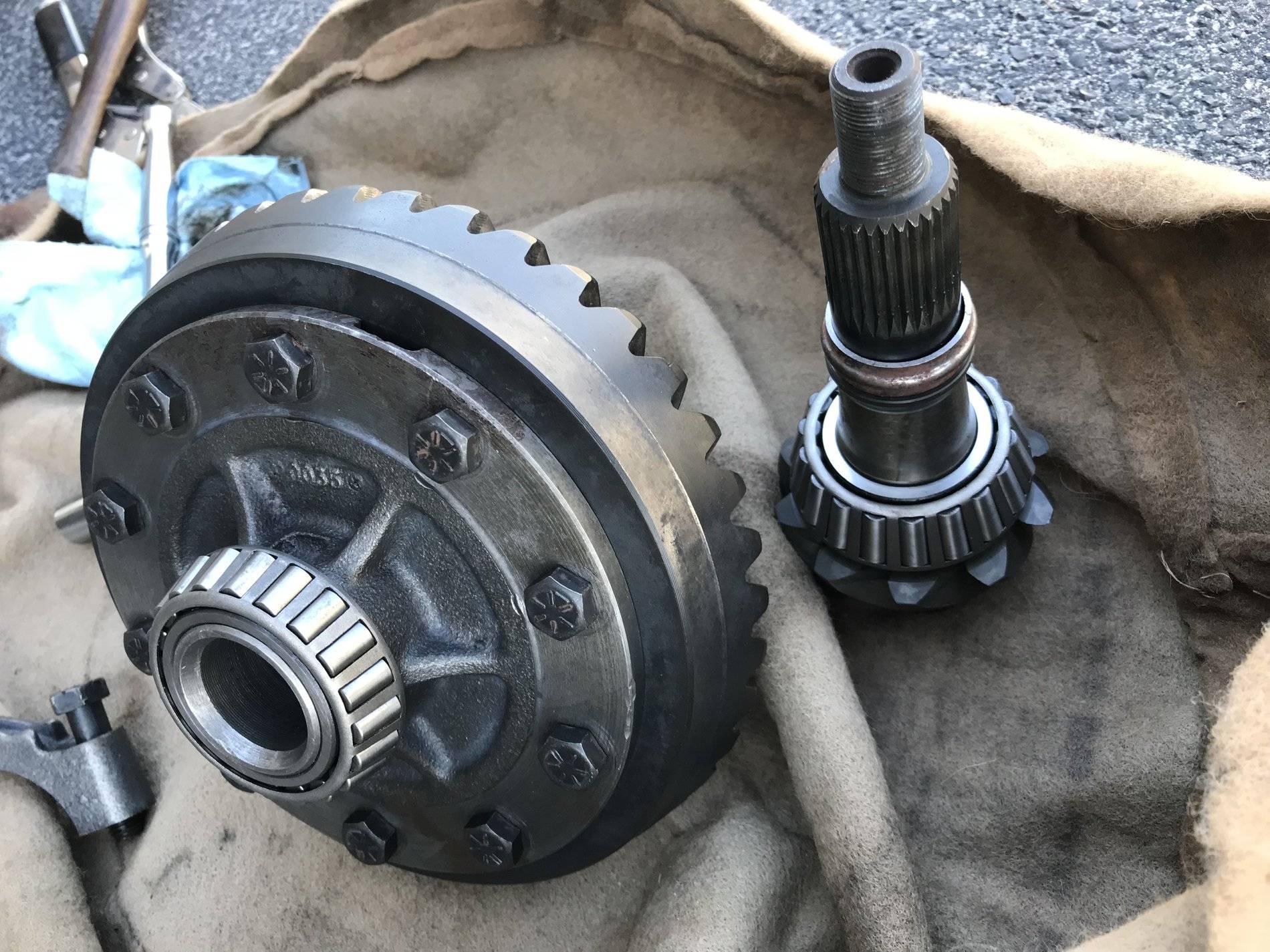

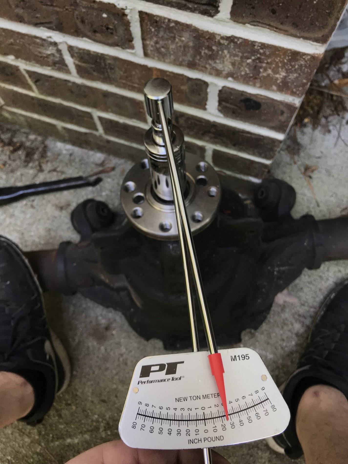

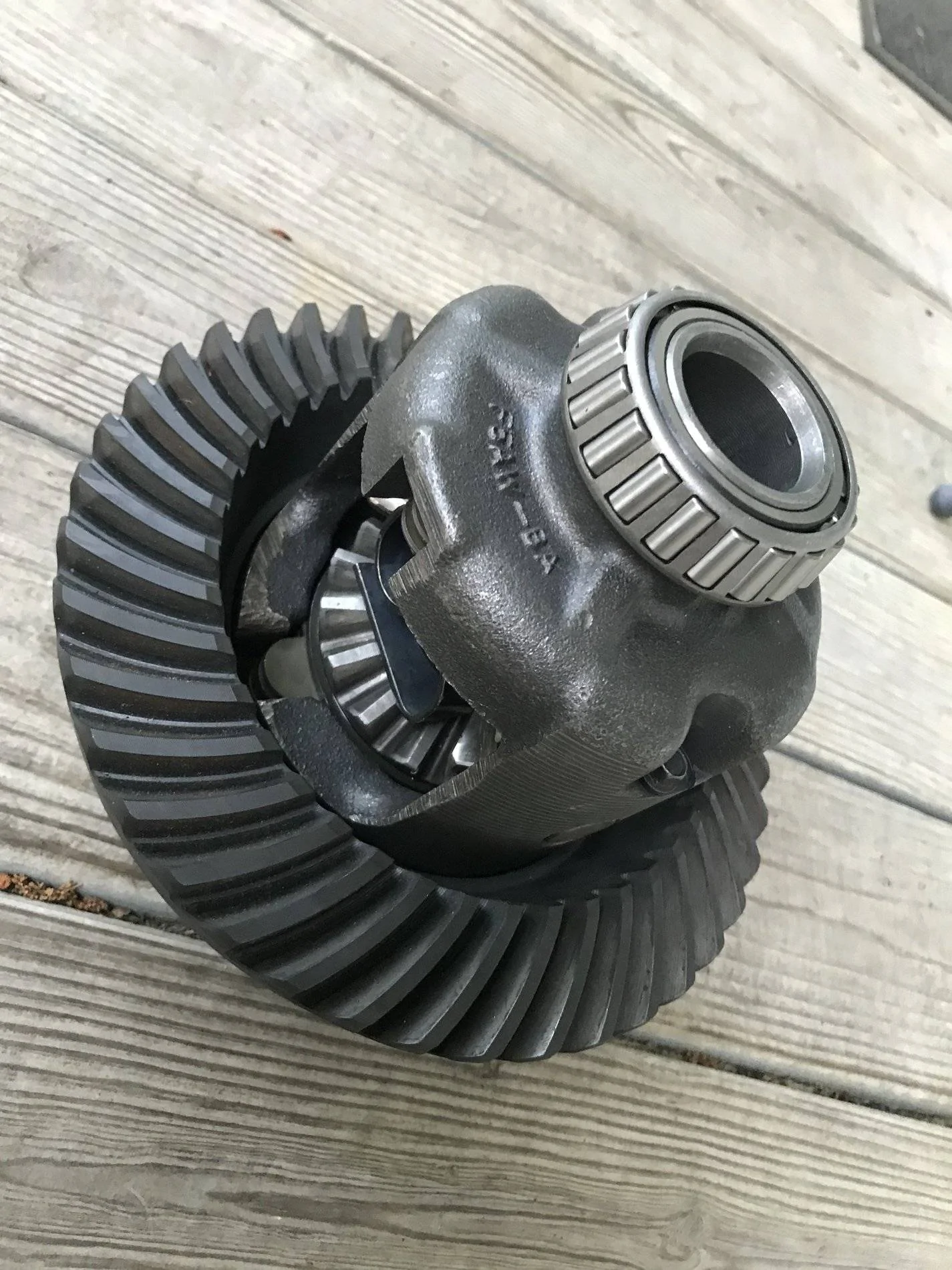

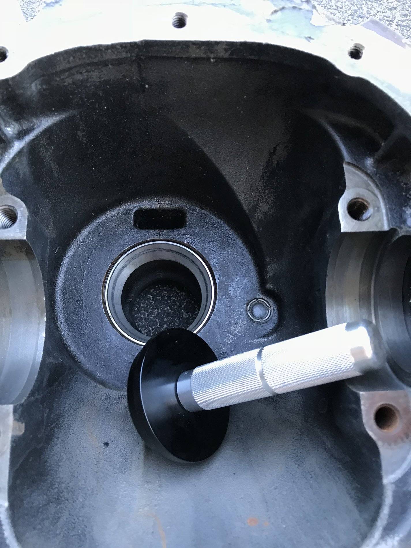

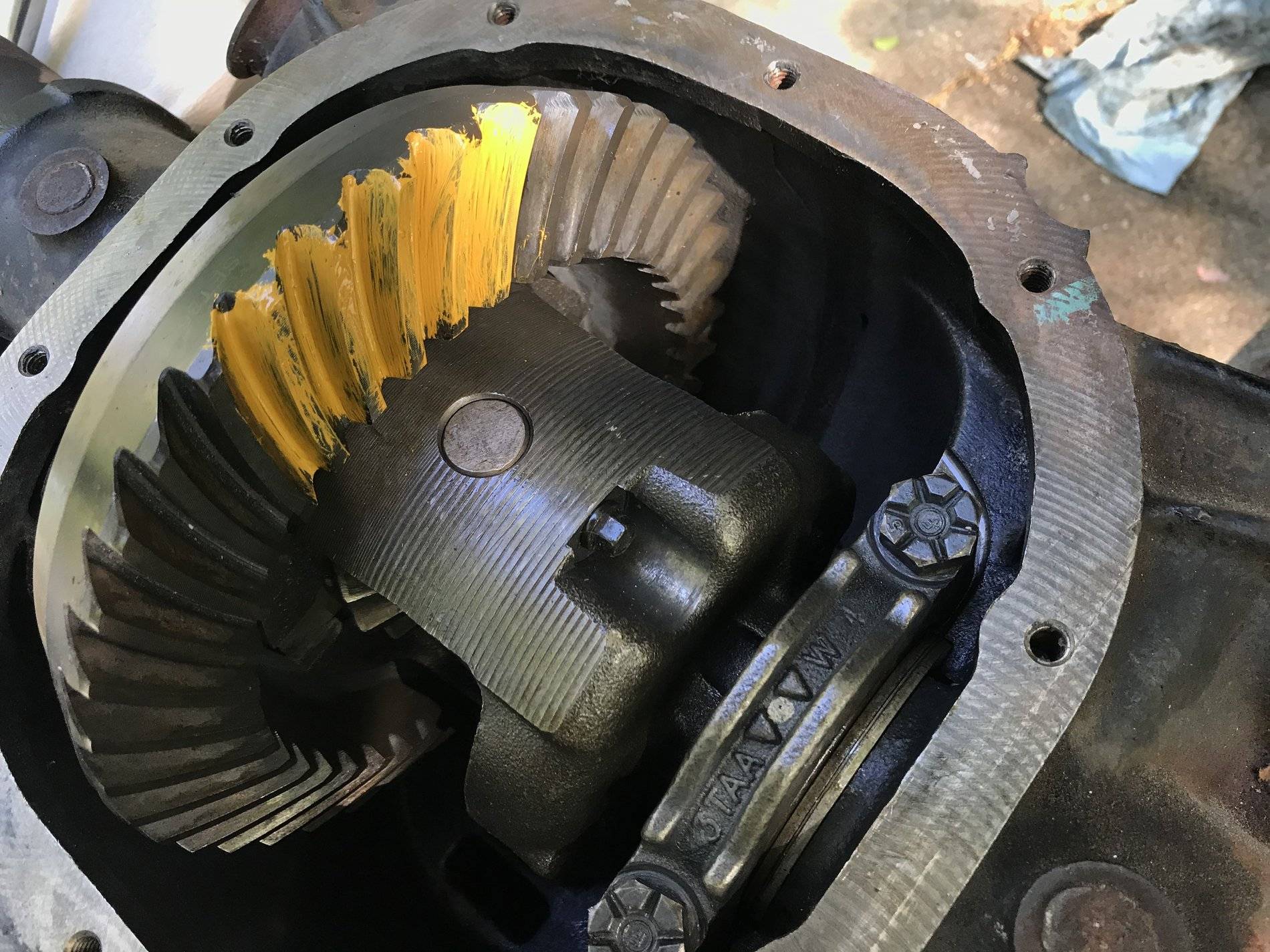

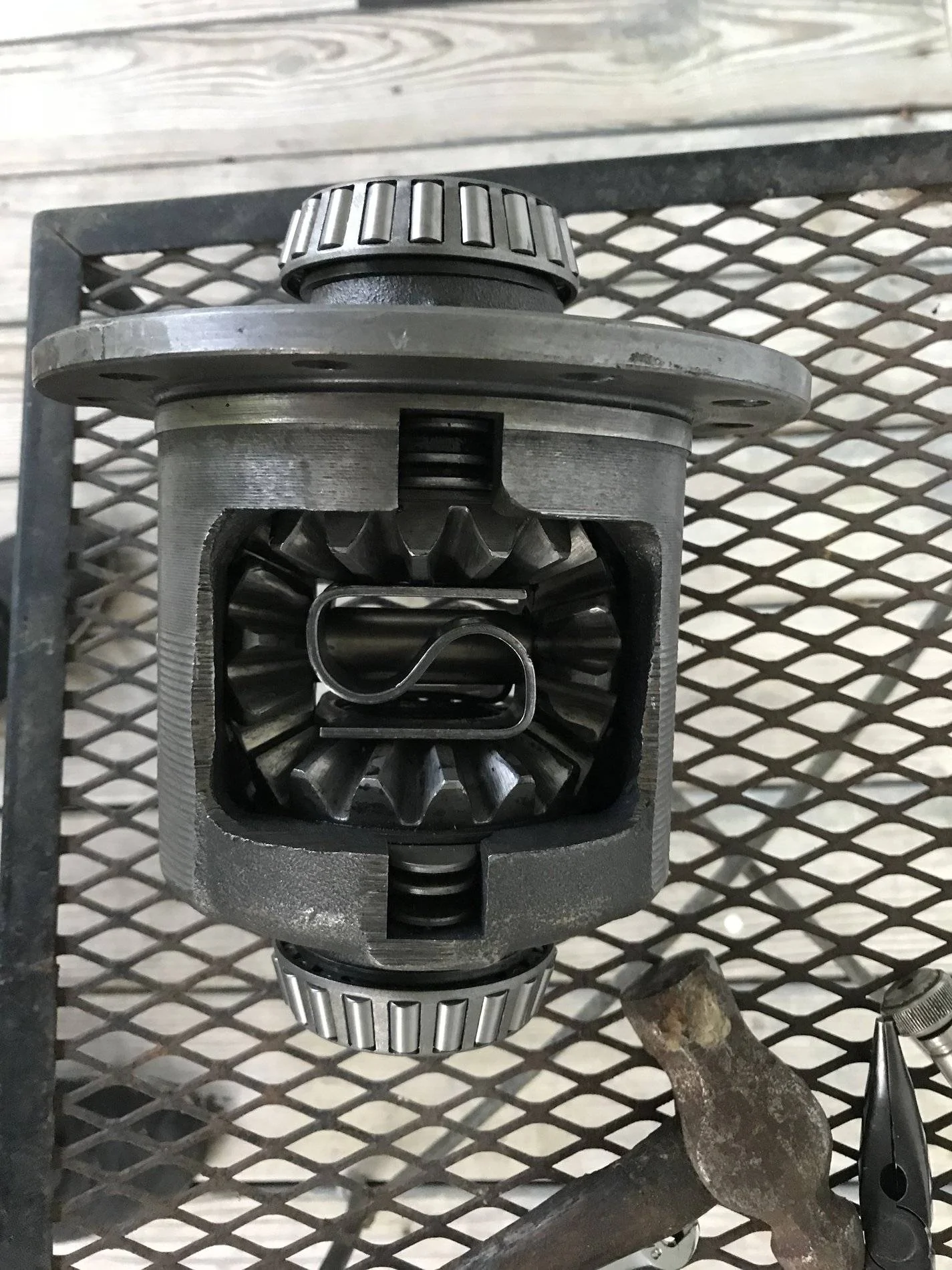

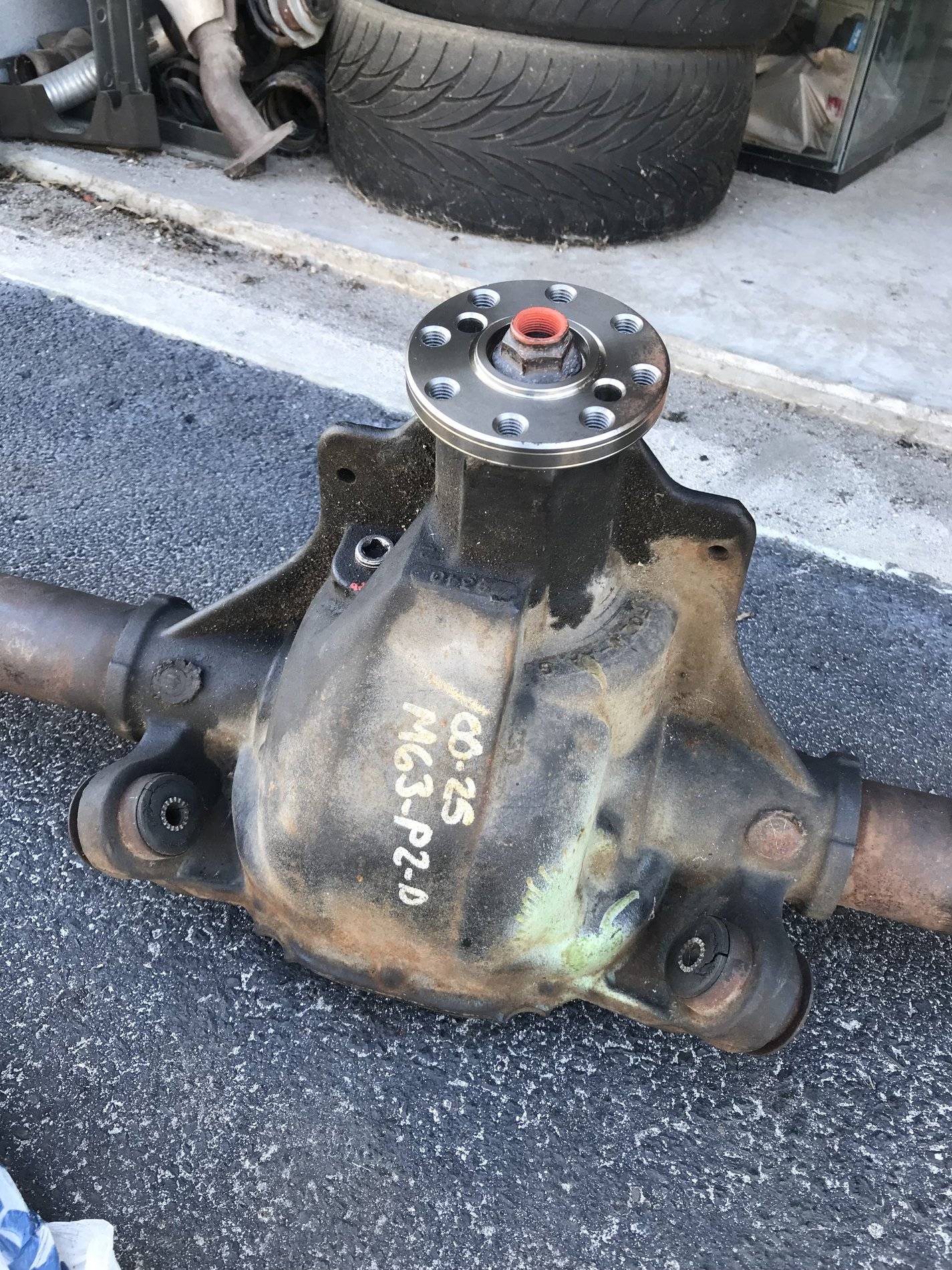

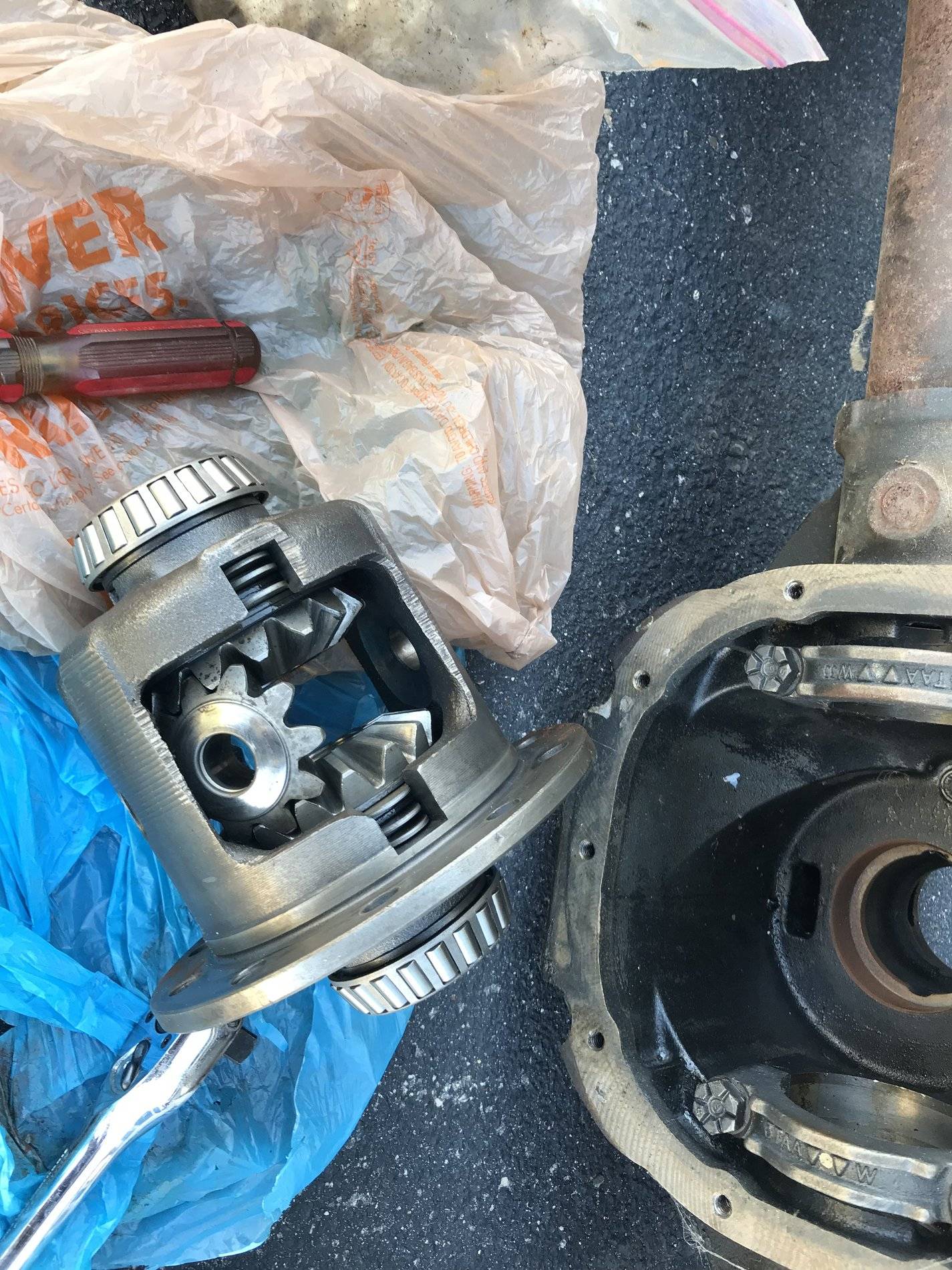

Have the 8.8 from my 2000 GT that’s been out of the car for a few years. Needed a full rebuild so before I moved and had to drop the project, I ordered a Motive full bearing kit and FRPP trac lok rebuild (carbon clutches). It’s a little 28 spliner, but it’s been a trooper. Probably should have replaced the spider gears but if I can accomplish getting the axle assembled in a few days I’ll be happy with that.
