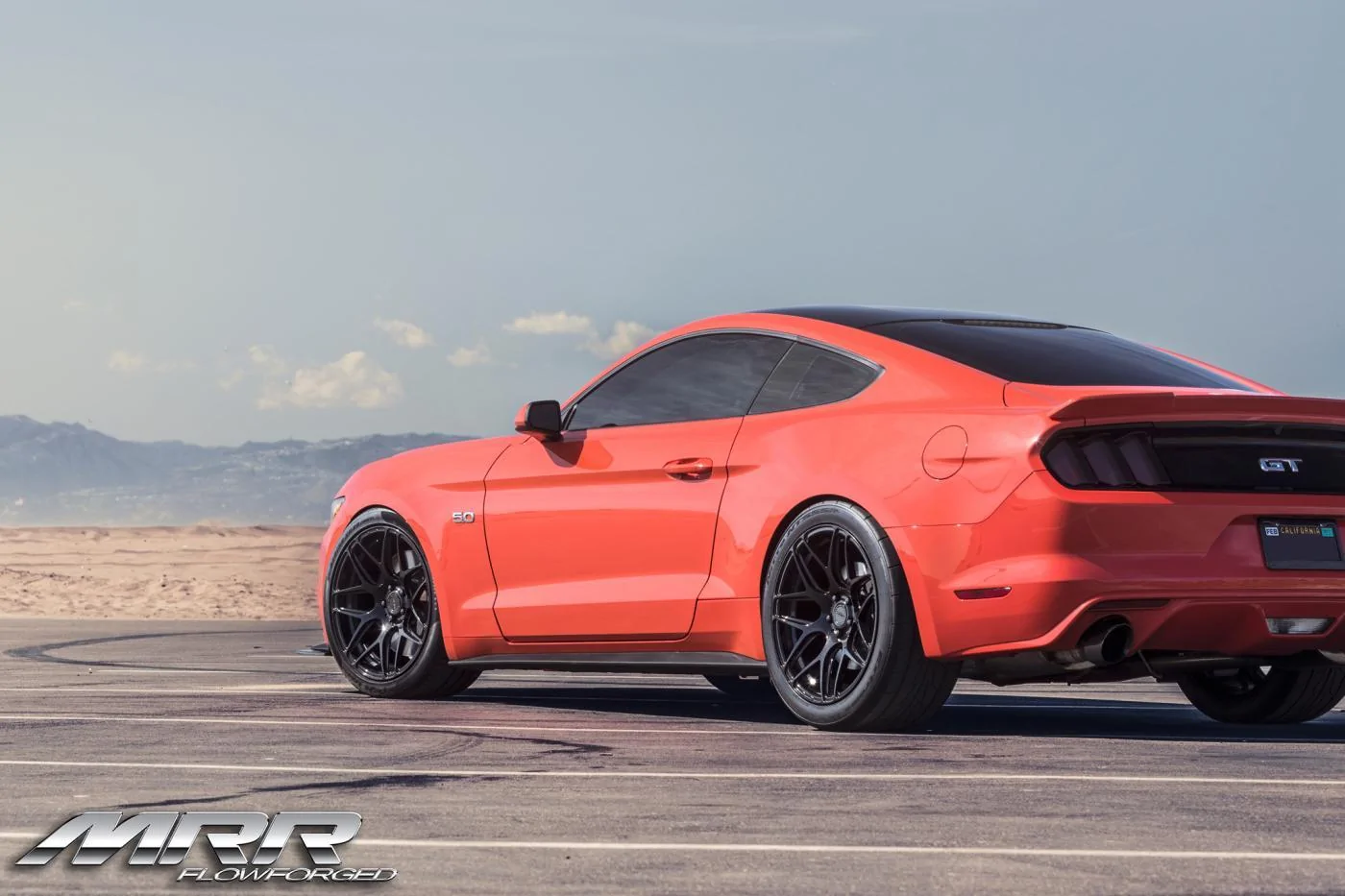

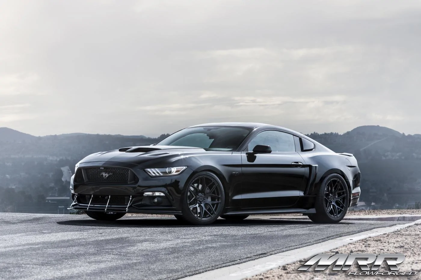

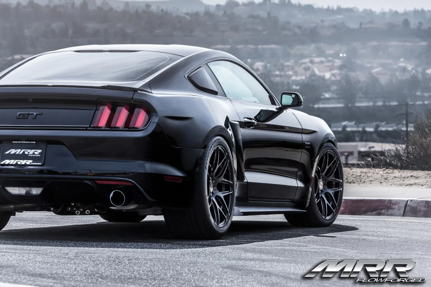

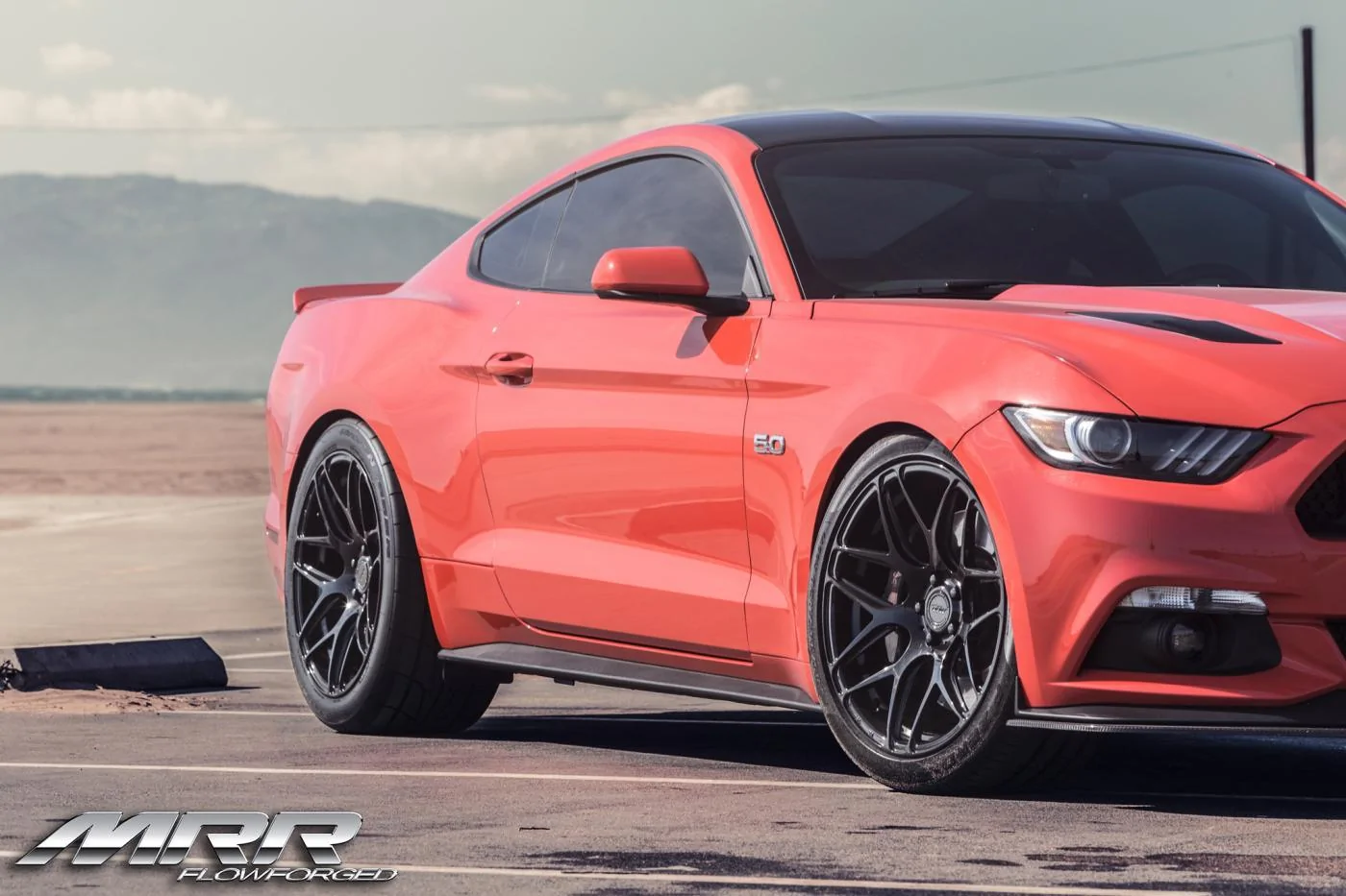

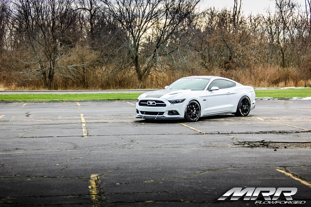

Sorry to hijack but what is the widest tire on the M350 19x10 and 19x11 without rubbing. Rim looks good and light. hard to beat for the price!
We have seen guys go up to a 285 front and 345 on the rear with the Nitto Invo tires.

Because of the m350 offsets widest I recommend is a 285/325 application
Now if you wanted a mean setup we'll we just finished a vs forged application using a 305/345 application.
