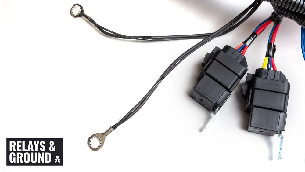

Each harness will include 2 or 3 relays, depending on which harness you order. These will control the pumps. The relays are powered via the fusible link and have attached black wires which are the grounds. You will need to ground these to an appropriate spot on the vehicle.

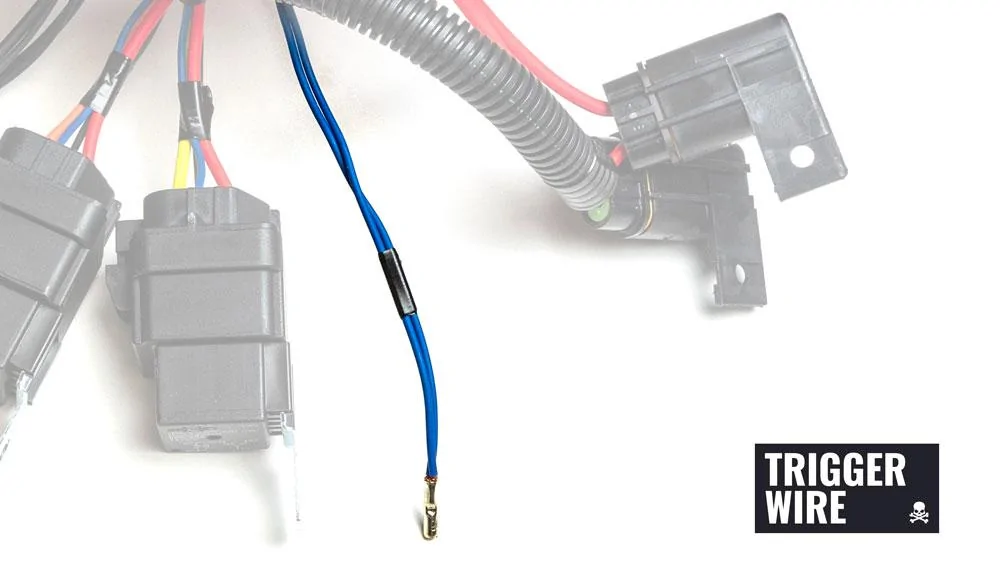

Also attached to the relays is a blue wire. This is the trigger wire that will tell the pumps to work. It can be wired in 2 different ways, either as a ‘key on’ setup or to prime like the factory pump(s).

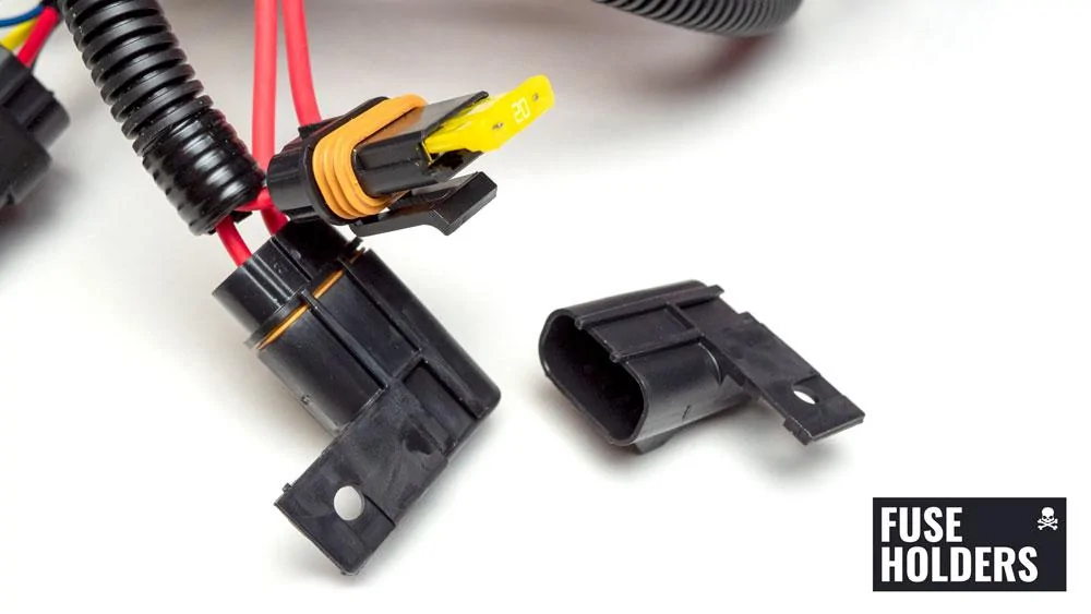

After the relays you will find 2 (or 3) fuse holders wired in, each containing a 20amp fuse.
These fuses protect the relays if there is a short between the pumps and the relays. The fuses can also be upgraded to a larger amperage should you need it for larger pumps.
