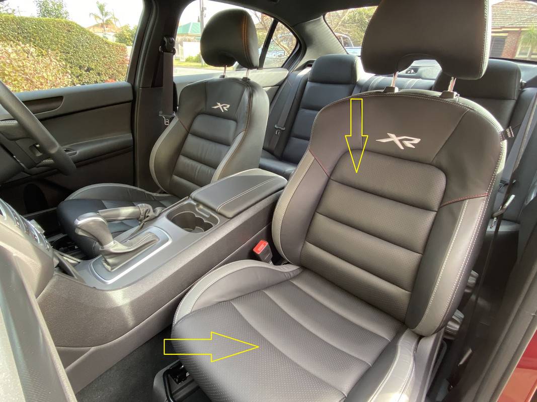

100% genuine leather is not something that is deemed suitable for most people's expectations. As such, car companies use a product called "coated" or "split" leather for durability. This material is used on the bits you sit one or against. Think of this like the clear coat for your paint, as in its a top layer that protects the finish underneath. This pic is of my Falcon, but the concept is the same, the arrows pointing the real "leather".

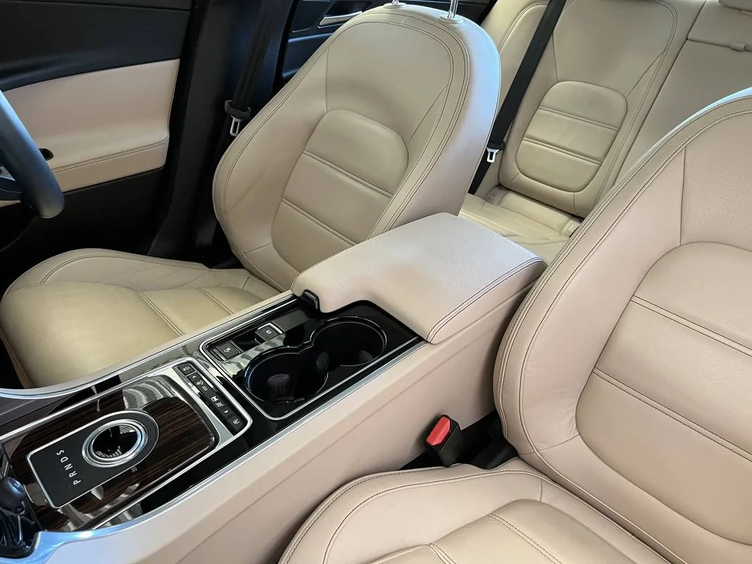

Other high impact and lesser seen areas are made from industrial grade vinyl. Think seat bolsters, seat backs, gear shift surrounds and door panels. This combination of coated leather and vinyl is more widely used than many people are aware of. This is our Jaguar XE, a brand known for its leather prowess, it too has the same combination of materials.

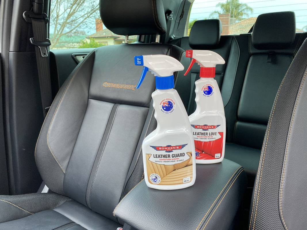

Bowden's Leather Love and Leather Guard are both products that leave a clean, matte finish on automotive "leather". Leather Love is a mild cleaner and protectant, which can optionally be topped with Leather Guard.

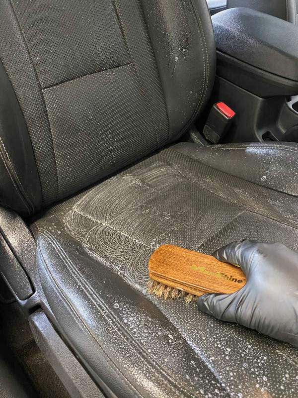

If you want to increase the cleaning ability of Leather Love, team it with an upholstery brush.

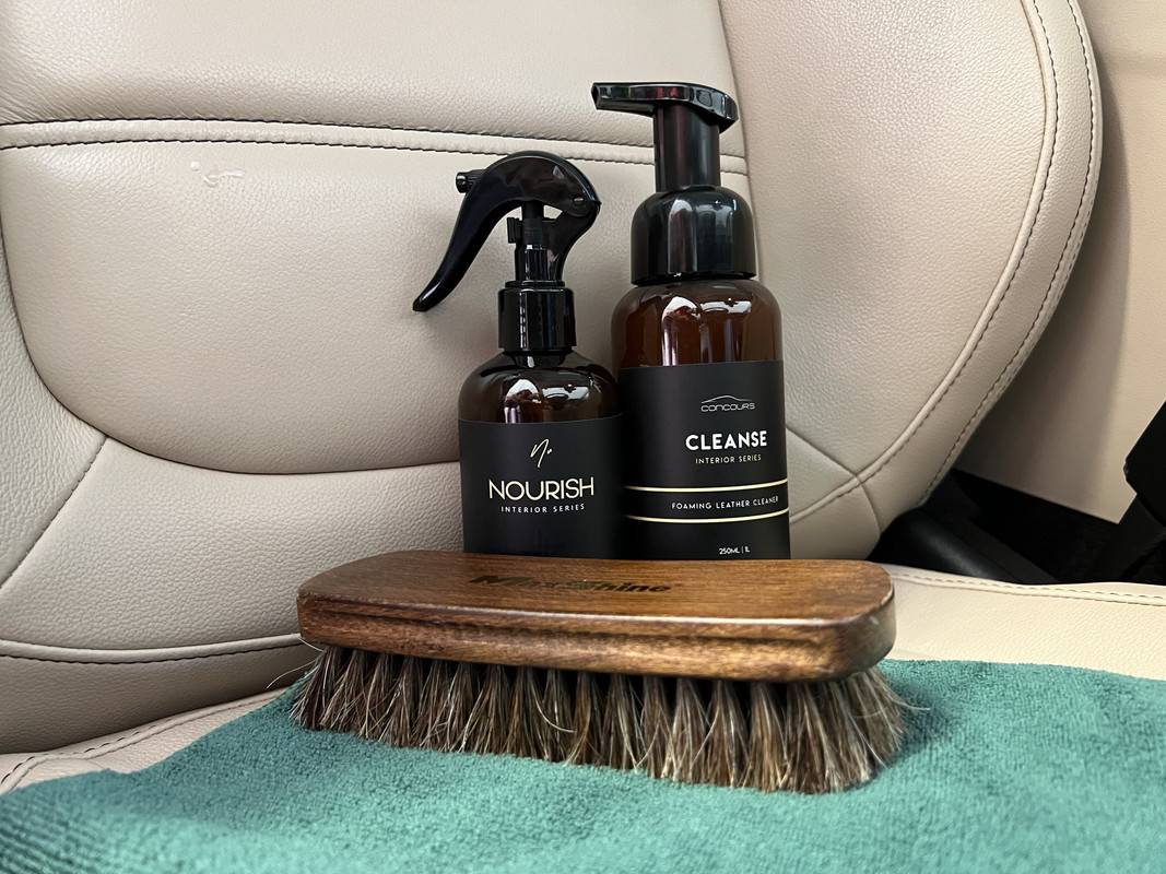

NV Cleanse and Nourish are similar products, I like how these are largely unscented, products that I am using to maintain my XR8, which still smells new 8 years after it was made.
