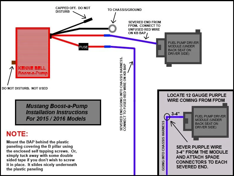

Our packages include KB's Boost-A-Pump, while the base KB package does not. As such, we include a write-up on how to do the install in any S550 GT. Here's a copy of that for those interested:
