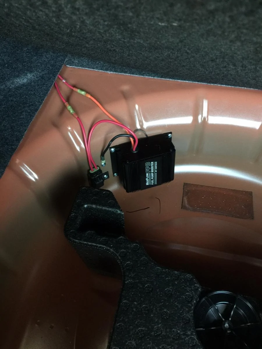

Where are you guys mounting your JMS PowerMAX voltage boosters? I just completed my Whipple install, but I still need to do this? Any suggestions? Pics would be appreciated.

Trunk..

We installed ours in the spare tire well in the trunk.

Trunk.

Drivers side Trunk rear quarter wheel well. ( behind the carpet ). You can route wires along factory loom (behind rear seat panel)

You can feed your extensions through the hole above the well and down the factory loom. Its perfect and there's even a factory ground tie in near the module. :cheers:
Just use some velcro (advance auto..etc) and stick it to the wheel well on the hole side.

mine is under the rear seat on pass side below the rear panel...perfect location in my opinion, its out of the way, easy to access if you need to and doesnt use up any of your trunk space

I have mine under the rear deck. I can open the trunk and the settings are facing you if you needed to adjust. You don't know it's there until you look for it.
exactly what I did. works great!

For simplicity, and because I was tired of my car being a hangar queen, I just Velcro-ed it next to the tire repair kit. I plan on moving it to that useless space behind the driver side wheel well when I have more time, but I had to get the car running so I could use it this week and the supercharger install took WAY more time then I thought it would.
