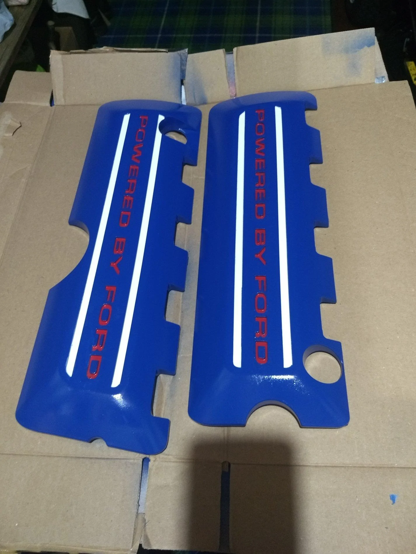

For those of you that want to paint your own, I'm not going to go into detail as to how much time I took taping off letters to get one of mine done, only to find out a ridiculously simple way.
If you tape off the lines and spray the lettering, then later tape off the lettering and spray the lines. Wait for it to dry and then you can go back with one of the harder foam rollers, I used a 3in one, and just roll on the main color. With a paint tray, spray your spray paint into the tray then soak some up with the roller so that it's closer to dry then saturated. Now you can go right over the lettering and the line without getting any paint on to your previous work. I would have some overspray remover and a rag handy just in case you get a little overzealous and a little spatter gets onto your letters or the line, but if you are careful with how you get paint onto the roller it doesn't leave anything behind at all.
I just have the clear left to spray on

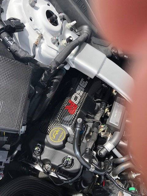

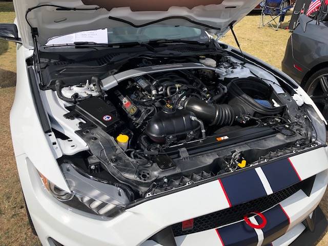

another great option is carbon fiber. I got these from MPR Performance. They come with GT350 or GT350R graphics. I have a 2019 R. They are high quality, look distinctive yet could have come from the factory, great fit, and get lots of compliments.

Those look great! Trying to figure out which direction I want to go.

yeah, that carbon fiber option looks great!!
