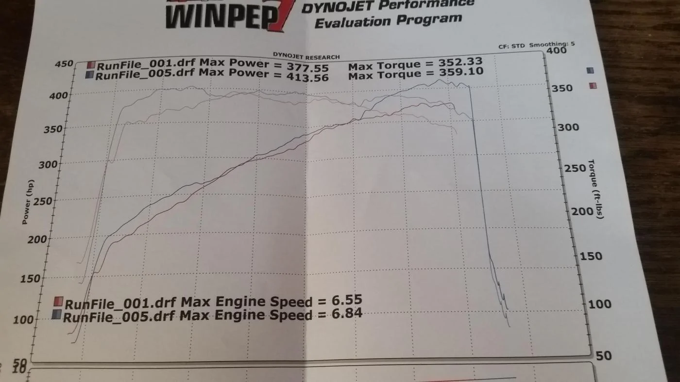

Those revised cylinder heads are just begging for less intake/exhaust restriction !!

Log your car, I bet it's closing the throttle in the midrange and why you didn't see any gains there. This should have been fixed in the tune. You should be making 380+ RWTQ. Lots left with tune changes.

Odd that it only made that. Mine made 417 with 102 miles on it. All stock. Just a Livernois tune. Going back this week with 93 octane. Just too see.

You cannot compare numbers from two different dynos.
You car 417 at your dyno may only dyno 350 on another.
Dynos are good to get readings for before/after a change. That way you can see the difference as KenB posted above.

Same dyno same day
