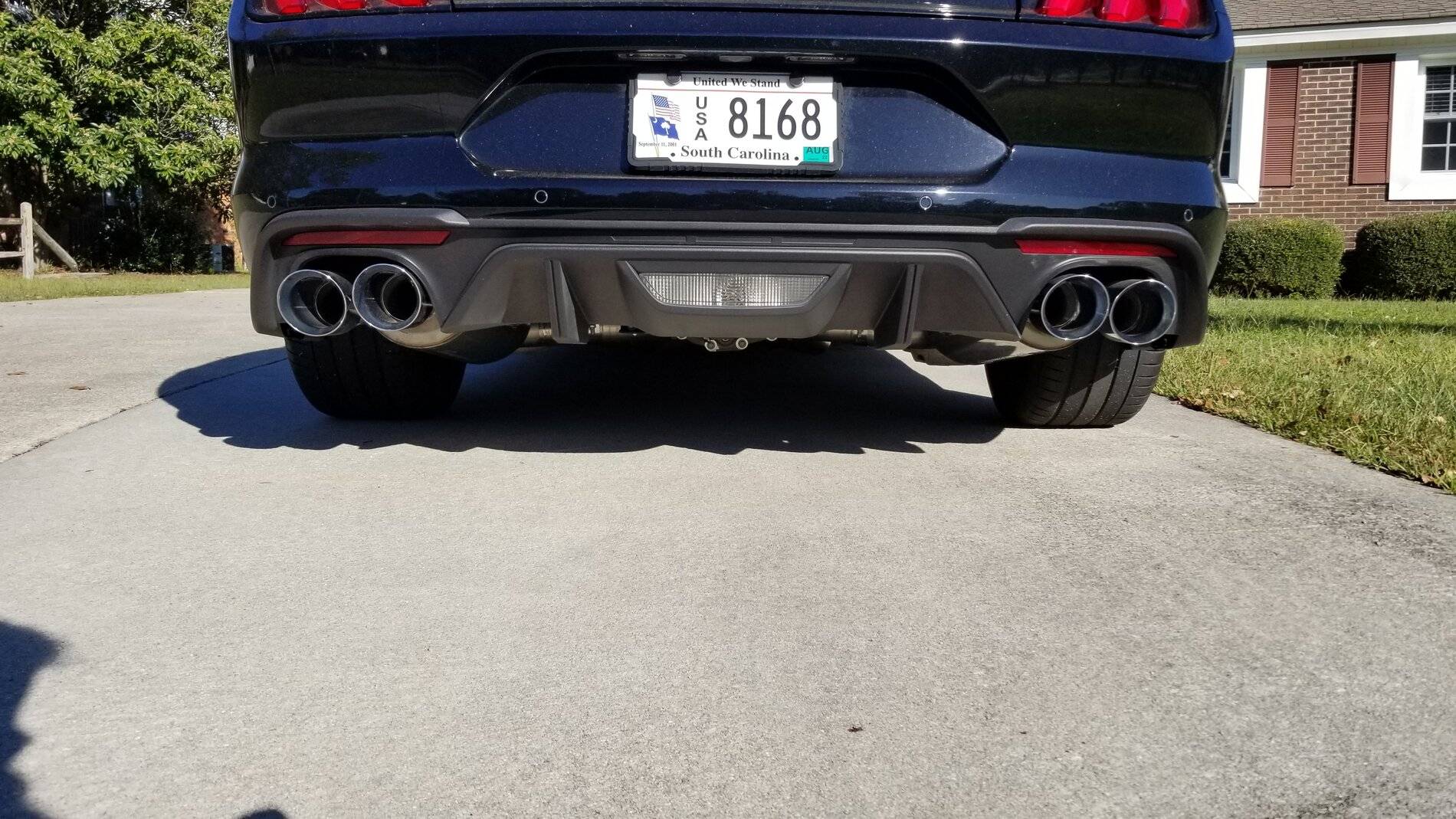

hey how did you correct the slant on the passenger side? thinking about throwing this on this winter and dont want to have it look like that. it looks great now though.
AMC401V8
Jul 9, 2020
129
141
Kentucky
2020 Mustang GT - 2000 Excursion - 1987 Swift DB2
Loosen the clamp at the h pipe, adjust to your liking and tighten back up.
larr12
larr12
Jul 9, 2020
1,117
1,708
Alberto
2020 Mustang PP1
With the help of my kid, I installed the pipes and mufflers but did not tighten the bolts. I kept aligning/moving the pipes and mufflers until they were almost perfect.
After that I started tightening while my kid made sure nothing moved. Once everything was perfect I moved to install the tips.
I think it took me more time making sure the tips were aligned than installing the whole catback. Lol.
