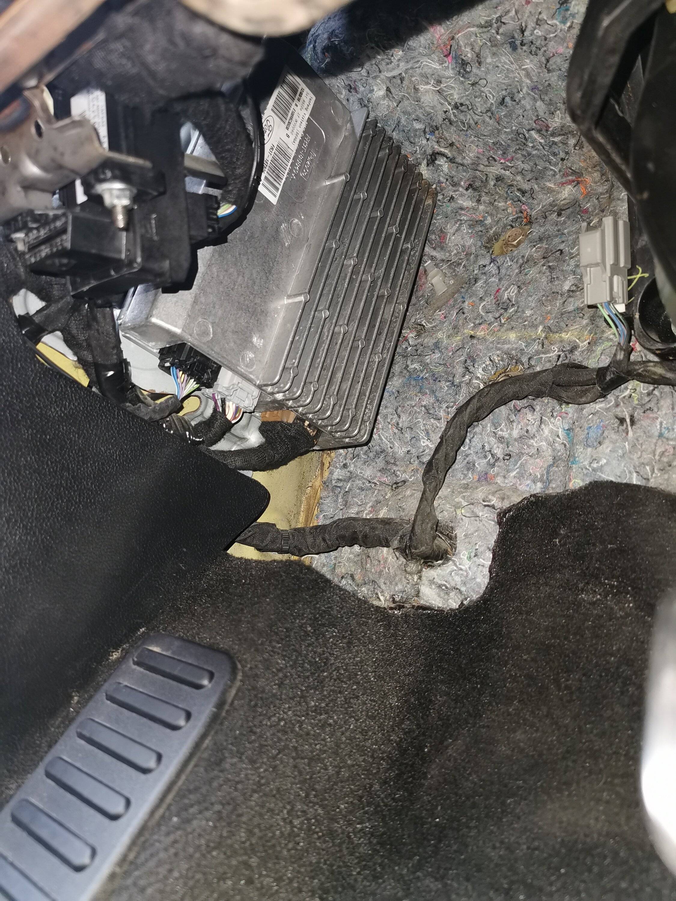

Hello guys i have locates the noise, it goes from amplifier control unit. Under then driver side dash (fixed to wall). As in picture and video.
Probably because of hot weather it cooler makes such noise. Anyway, did you have similar issue? Any advise how to avoid the noise from that box? Thank you
