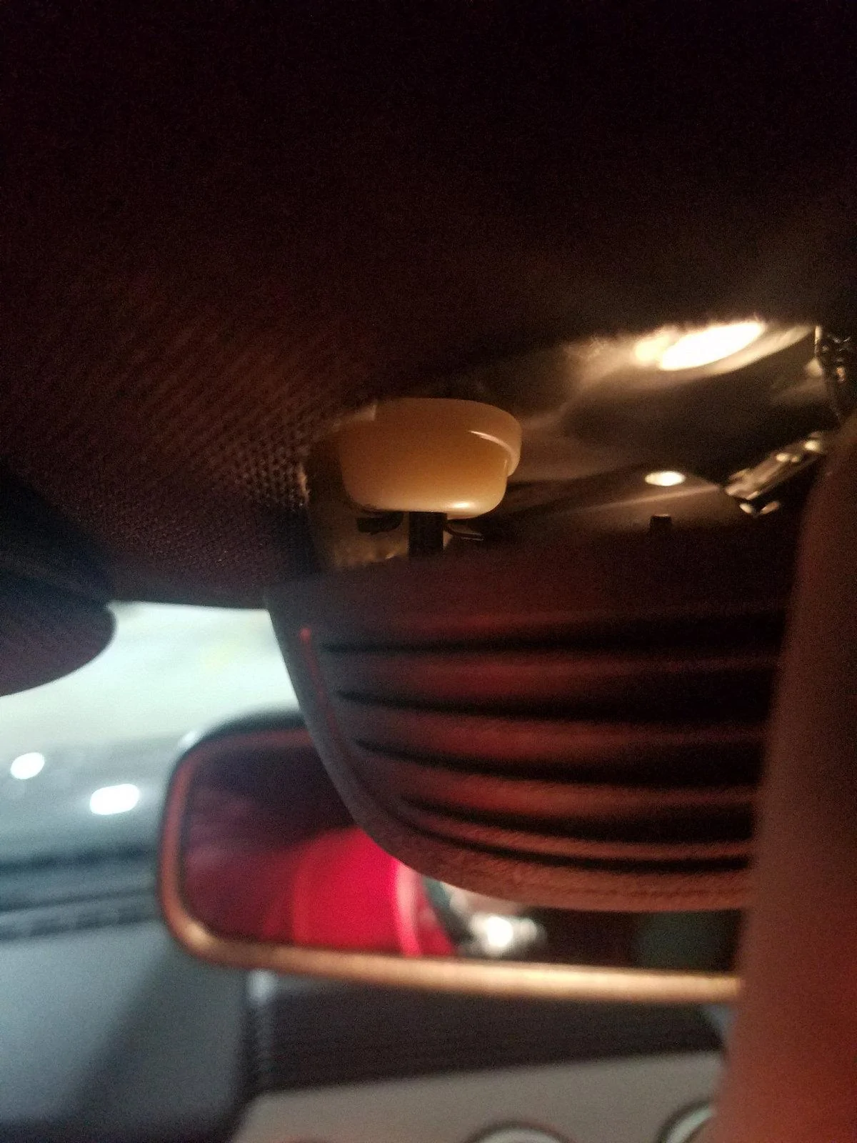

Yes, it is the same exact housing. For some reason they just changed the clips actually holding the housing in place. They seem to be cheaper and are fully made from plastic. When I try to take it off the same way I took it off on my 2015, it just bends the clip and stretches the plastic. There is actually a small gap now between the headliner and the housing in one side due to that reason.

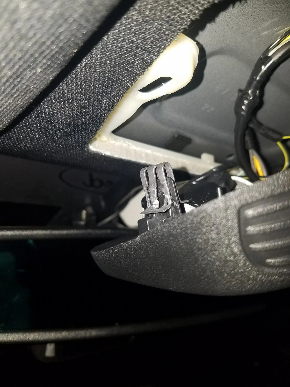

How are you trying to get the housing off? I'm curious how you know for certain the clips are different without removing the housing? Any sag or gap is from a clip being pulled off its support mount. Easy to fix...... once the housing is off. ;)

Your second pic is what I was trying to describe about the clip being pulled up off its support.... a pic is definitely worth a 1K words. It looks exactly like my 2017. Congrats on getting it off..... so how do you like the your new LED's?
