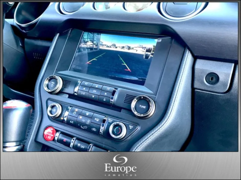

Thanks! Thats what i thought. But I found this 2017 car in Europe for sale. Should be brand new 2017 model. See attached picture. As you can see it has big screen and no switches. Thats why i am confused...I will ask seller.
So basically for base models i have to select sport mode by button on steering wheel,right? Or anything else? And the car stays in sport mode permanently even after i turn it off?

For the base model, you use the left side steering wheel buttons to change the modes in the info screen (between the 2 round gauges). You have to change the exhaust to sport each time the engine is started.
Your picture shows what appears to be a hybrid set-up that is not US spec. It looks like it has the base HVAC controls and lower switches and the upgraded radio controls and a larger screen. I believe the upgraded US spec screen is even larger.
I think that has one of those aftermarket touch screens.
Similar to this:
http://www.mustang6g.com/forums/showthread.php?t=59561
