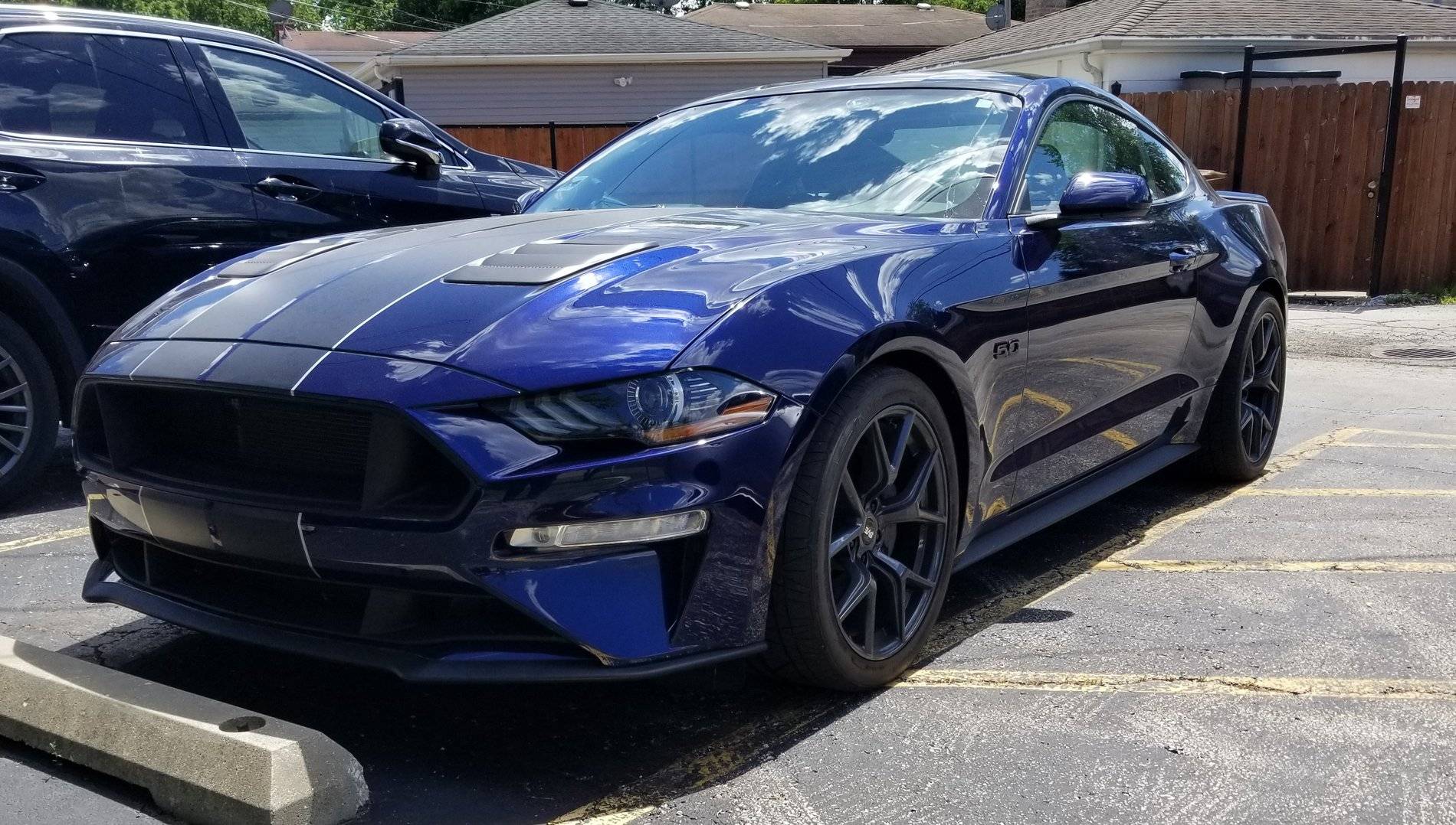

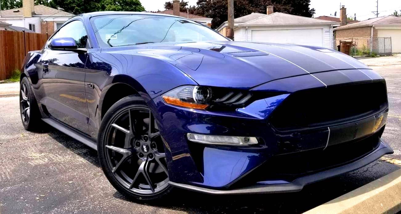

Between the stop the hop starter kit, and drag springs, the car has way better traction now. A solid 85% improvement imho. Sits just how I want it to also.
LSchicago
LSchicago
May 11, 2018
93
2,914
2,544
Illinois
Lloyd
2018 Mustang GT/A 301A 5.0
Today I loaded the new E85R tune in, and put the car in drag mode. Lost all traction (even on concrete). Spun through 3 gears. Hello Drag radials.
