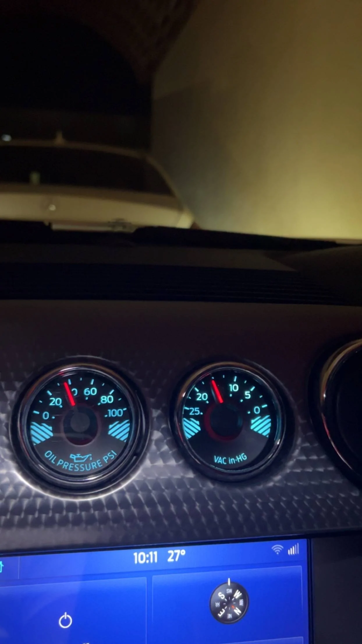

PP Gauges into Premium 401A.

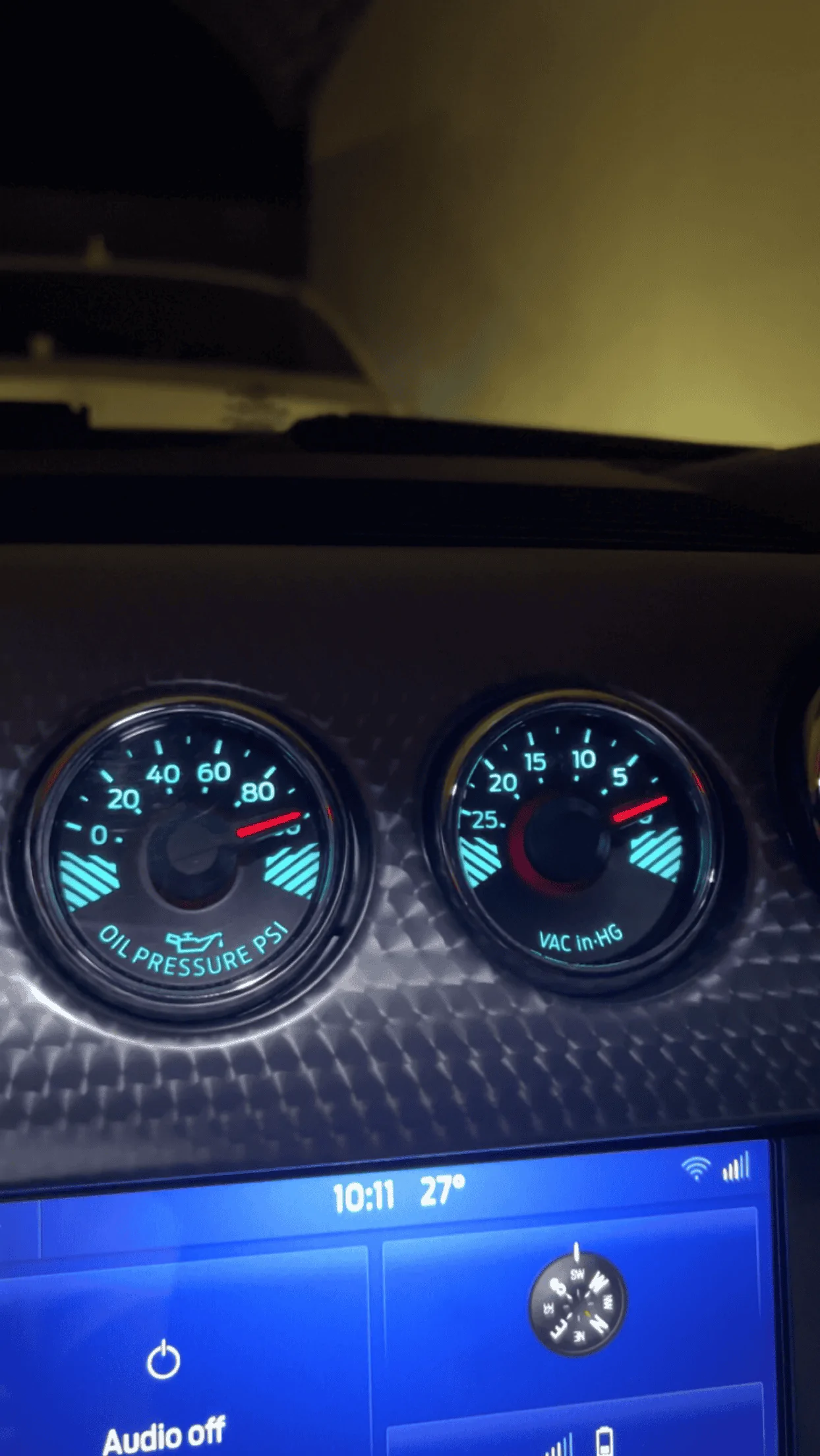

First I hope everyone reading this is having a really good day. I really need help with an issue I’m facing. I have installed the PP gauges on my GT/CS ‘17 the wire was hanging right behind the sync screen. Plug and play! The vacuum works right away as well as mycolor. However as many of the guys who installed this gauge, the oil pressure is not working and after using hptuners where I change from switch to transducer the gauge works just once! Now every time I start my car the oil pressure is at 100psi!! Once in a day it will work with no issue as soon I turn the car off and restart it again it will go back to 100psi it does not matter if the engine worm or cold! Any idea why it’s doing this? What can I change in hptuners that can help to read the pressure? Car is stock no tune I only programmed them fans to kick in sooner after installing Mishimoto.

....Now every time I start my car the oil pressure is at 100psi!! Once in a day it will work with no issue as soon I turn the car off and restart it again it will go back to 100psi it does not matter if the engine worm or cold!....
Are you saying it stays at 100PSI continuously?
Yes and it sure read wrong cause on my cluster oil pressure Says normal!! However when the gauge is working, a message pop in saying low pressure oil which is normal from what I read from others who install the gauge.
