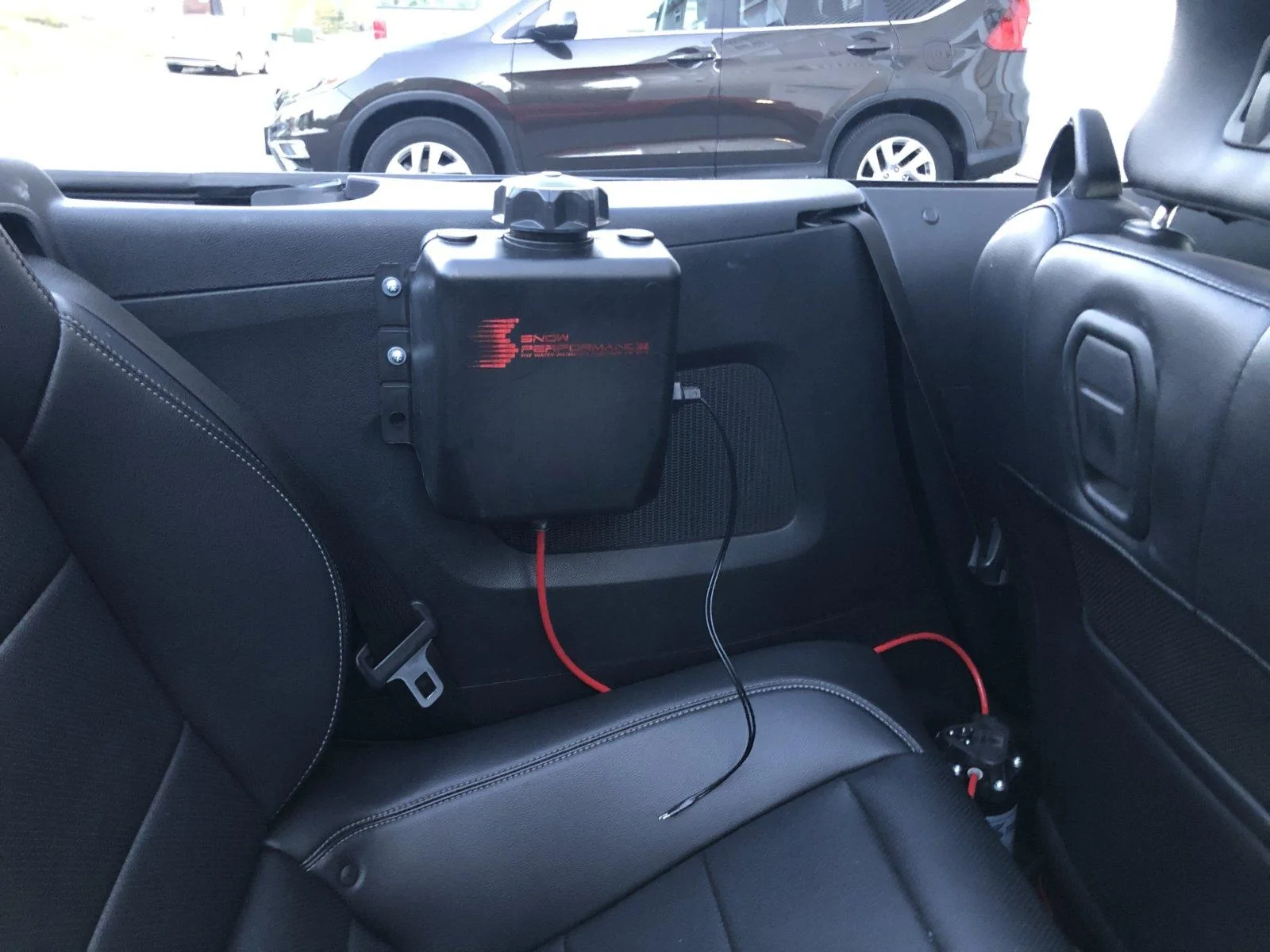

I do - looking at the back seat, the reservoir is mounted high up on the driver side rear of the speaker and just above it. And the pump is down in the corner by the floor. Injecting into a C&L throttle body spacer.
I was expecting it to siphon I guess - I read the instructions a dozen times - spent an hour looking for a spot for it under the hood and just couldn't find anywhere I could put it without making a bracket or that would be easy to fill.
Just dumb it doesn't come with the anti siphon solenoid I guess - seams like something everyone should have or use.

Understood. Well - you were right to expect the siphoning, then, since you have introduced both conditions that create that issue. :frown:
Lsiunsuex. I would be careful of the interior mounting. Meth can be toxic, corrosive and hard on the optic nerves. Should you be in an accident, you don’t want it splashing on you or a passenger should the tank rupture.
I... didn't know that. I thought with the water dilution, it was pretty safe.
Now that I have the upgraded solenoid - maybe it's best to just trunk mount it and keep it away from passengers... The holes in the interior... no one ever sits back there and a little black silicon will fix it, lol...

Speaking of the solenoid, the best place for it (if feasible) is closest to the nozzle. Engine vacuum can suck the fluid out through the nozzle to the point of the check valve/solenoid so if they are installed far back, it'll increase the WMI spray lag as the fluid fills up the emptied out tube first.
