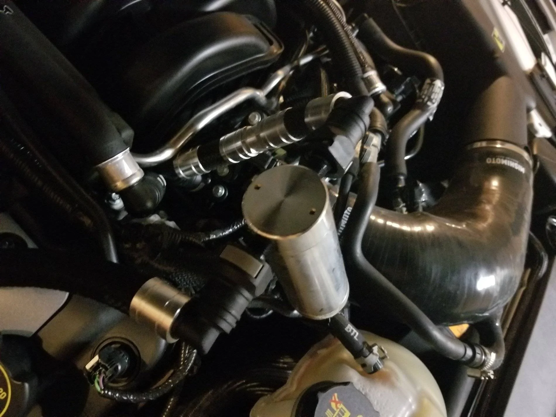

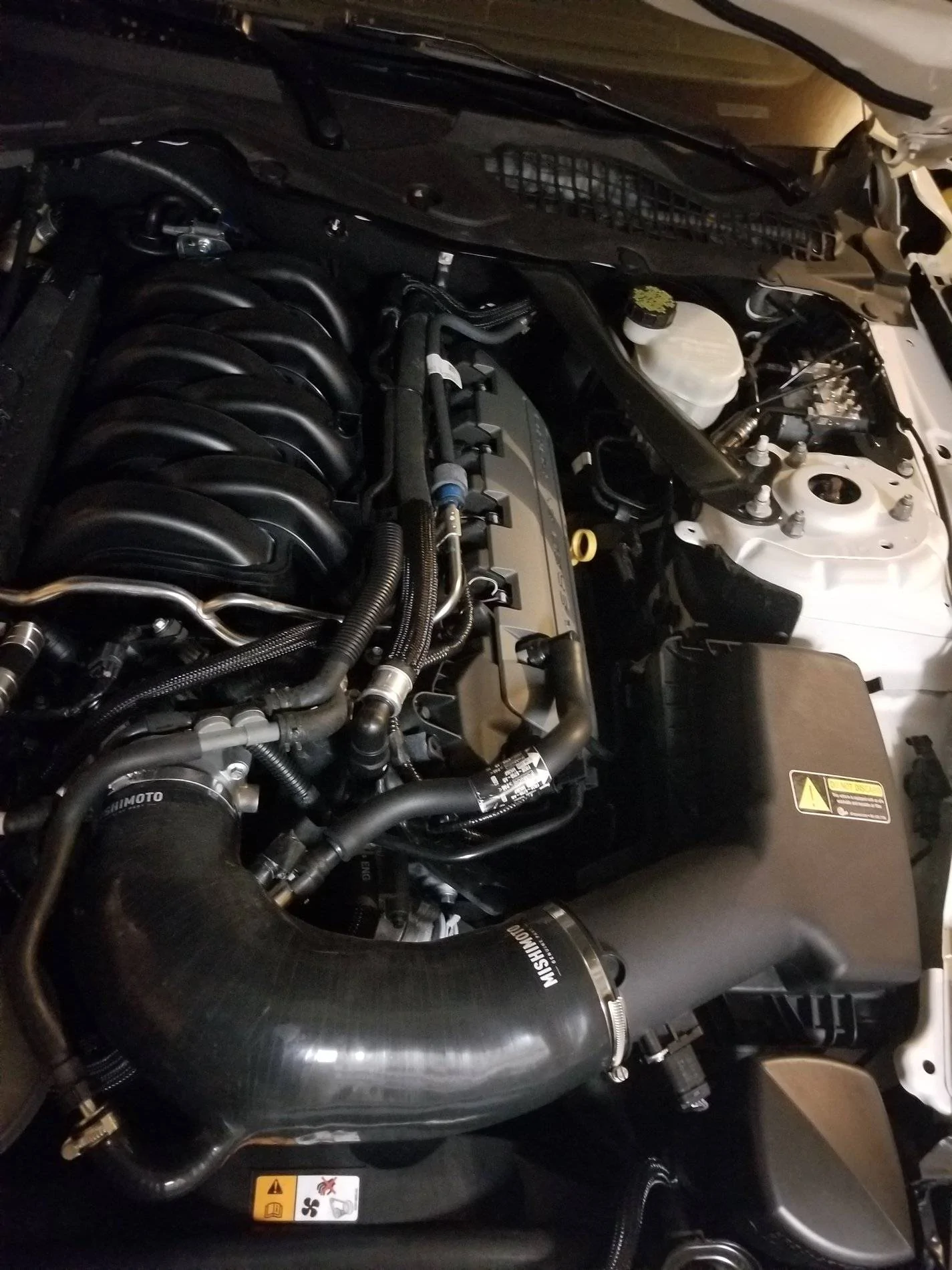

Hello I'm buying a 2017 GT premium and I noticed a few things when I was inspecting the car. I noticed the Mishimoto intake tube, and the intake looks like a GT350. Can anyone confirm the intake by looking, and the brand of catch can? Also has lowering springs which are blue which makes me think Ford Performance lowering springs.

Im not an expert so feel free to chime in but this is what I see.
Gt350 intake manifold, looks like a stock airbox (Maybe a 2018? Im not sure they make a mishi tube for the 18+ yet), injectors (basically required to run the 350 mani and I would be wiling to bet it has a flex tune), gt350 throttle body? (I believe this is also required to run the 350 mani but could be wrong) Sound tube delete. Catch can looks like a UPR satin.
5.0_SD
Village Idiot/Biermeister
Feb 24, 2017
1,138
402
Central Florida
Bill
17 GT Base Lightning Blue
Blue springs might also be Steeda.
