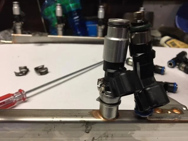

I am in the process of installing ID 1050x injectors in my 2015 GT and I was wondering if I am missing something because the rings look really small on the injectors. Is this normal?

You are good. They just slip in. Lube the o rings before you press them in. No need for spacers etc...

Uhm... looking a the picture again something looks off...where is the injector spray nozzle? May just be one of the differences in the 1050x vs the 1000...

Nozzle at the bottom,the o ring sit up futher but as long as it sits down in the intake i dont see it leaking.Taking the spacers off is not going to change wheir the oring sits at.

Don't worry about the o-ring size, they will seal fine.
No need for the OEM clips to be reused, just push the new ID injector into the rail, use a little clean oil on the o-rings, and the 4 fuel rail mounting bolts will hold them solidly in position once installed.

Thanks for the help. I just wanted to be sure since I have never installed injectors that didn't look the same.
